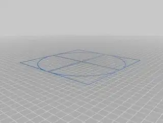

To quantify the offset of the center as it is known by the printer software (firmware) it is advised to print a large square that is a few percentage smaller than the maximum size of the bed. E.g. you can create a square hull at e.g. 90 % of the dimensions of the bed (parametric designs are very useful for this purpose, see e.g. this design). There are many things (.stl models) to be found on the internet. If it includes a cross, even better as some platforms have a mark in the center of the bed.
Example of a bed center calibration model
Once printed, measure the distance from every edge from the build platform to the printed square. If you fail to print the square, please check the level of the platform; this is also an excellent test for the level of your bed! The measurements should give you a notion of the offset of the bed. E.g. for the X-axis you measure a distance of 12 mm on the left and 8 mm on the right (when facing the printer) you can easily deduce that the center is (12 - 8)/2 = 2 mm to the right (positive X direction). This implies that the printer manufacturer has done a lousy job by delivering you a printer with an offset bed; better said incorrectly configured in their firmware. Note this is not uncommon!
