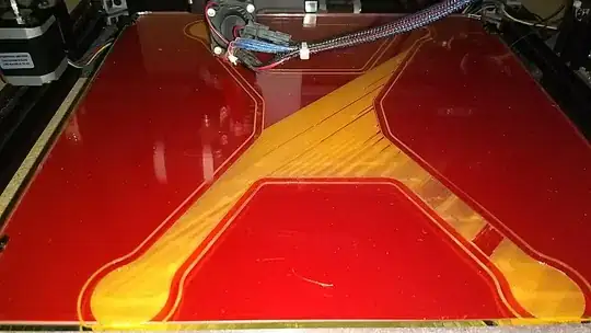

I've been printing PLA on a Pegasus 12" for 2 years. Print quality has been great but in the last few months the quality of the prints has deteriorated. After looking into it, it seems when the head moves away from the spool and puts the filament in tension (and pulls on the spool) the extruder cog slips on the filament. That results in traces where no plastic gets extruded the furthest away the head moves from the spool (the spool is on the left in the picture below):
See diagonal traces where plastic didn't extrude

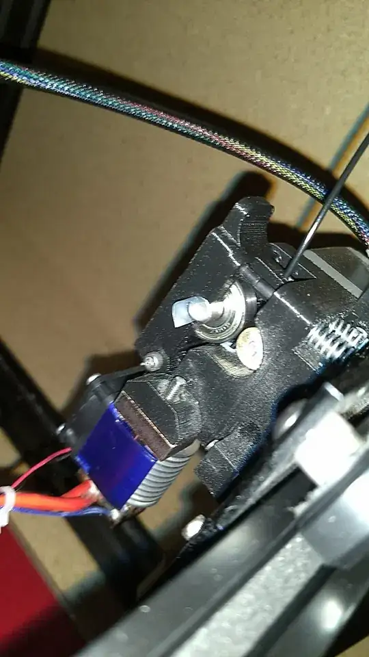

The cog slipping can be seen between 0:22 and 0:27 on the video below: the cog on the right spins continuously but the ball bearing on the left stops spinning for 5 seconds. https://photos.app.goo.gl/cTfySUgXDy1XKXGv8

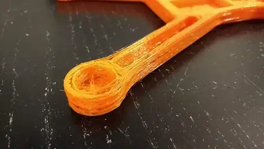

The end result is a part with multiple gaps, especially on the side farthest away from the spool.

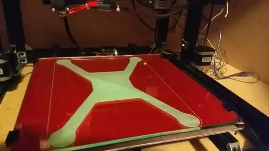

To complement Oscar's answer below, here is what I've done that fixed the problem: it turns out the issue was coming from a lack of friction on the filament. To increase the friction, I've slipped a pair of 0.25mm thick pieces of plastic sheet between the bearing axis and the mount. See pic below.
That increased the force on the filament enough to fully solve the slippage problem. The print quality is perfect now (see pic below).
