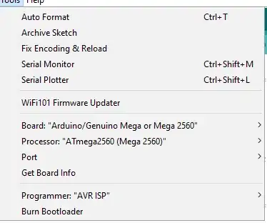

There are mainly three reasons for that:
  1. Arduino studio settings should be:
    • Board: Mega 2560 and
    • Programmer: AVR ISP
    • and valid COM port, please see below:
Arduino settings
