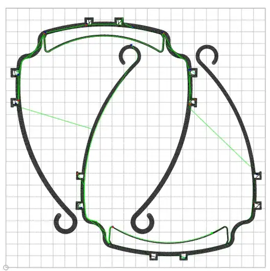

I have 3 printers, all Anet A8 with RAMPS 1.4 boards running identical firmware. One printer, however, has a Bowden extruder setup and RepRap 3 pin limit switches. Otherwise identical to the other 2 printers.
I'm mass-printing face shields, and I sliced the STL with 2 brackets at 180° angles and offset like so:
I'm trying to print this same G-code on all 3 printers. Same dimensions, same filament, etc. All 3 printers are on OctoPrint (separate Raspberry Pi devices)
However, on my 3rd printer, it's doing weird things. It will print the first layer of the frame facing the back. But when it goes to print the 2nd one (that's facing the front) it prints it right on top of the first one instead of offsetting it.

It sounds wrong to me, but it's almost like the machine is receiving the proper G-code but not processing it properly. Either that or something in OctoPrint is out of whack.
I've also attached the output from the terminal window in OctoPrint. I understand the commands, but darned if I can find where the error is occurring. I stopped the print right after it started to print the 2nd piece on top of the 1st.

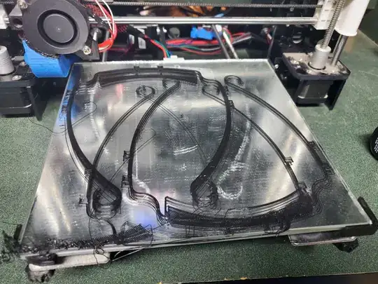

Edit 2: Adding image of behavior enter image description here

  • Can you add an image of what is happening? – 0scar May 04 '20 at 14:44
  • @0scar - Added picture. This time, it is randomly offsetting in both X and Y... – rtuite May 06 '20 at 21:09
  • This looks a lot like layer shifting, could be a mechanical issue. – 0scar May 06 '20 at 21:19
