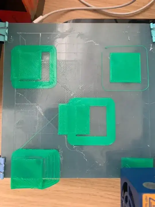

I have this printer with the 1.1.6 Marlin. The issue with it is when the printer starts printing the position of the hotend is offset
I am using Cura as the slicer. There, I tried this G-code to configure offset

But they are not applied.
What could be the issue?
Photo of a calibration print with some layers shifted
mr.M
  • 111
First, you need to make sure the slicer does slice the print object correctly, so beware of the option called "Origin at center" in Ultimaker Cura; this should not be checked for most printers (Delta printers have the center in the middle).
Second, please look into How to center my prints on the build platform? (Re-calibrate homing offset) to center your print to the build plate.
