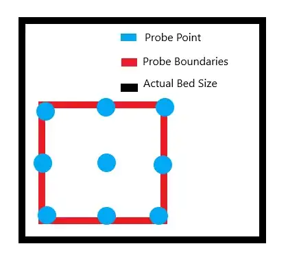

I have just installed the BLTouch on my Ender 3 running Marlin 1.1.9 and I want to set it up so the probing does the 9 points in a perimeter that uses most of the bed surface area. At the moment the probe just covers a small area.
I read that to sort it out you have to change the section " // Set the boundaries for probing (where the probe can reach)." but I can't figure out what to set it as, my current settings are as follows:

Any help you can give me on what I am doing wrong will be greatly appreciated.
