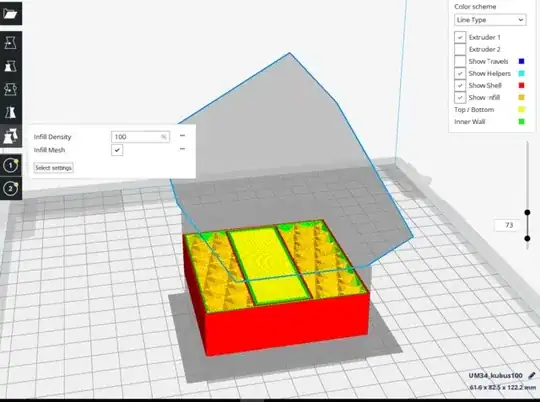

I've used a feature in Ultimaker Cura that can be used to alter the infill density locally. What you need to do is load your model into Cura, then load other objects (models) at the size of the area/volume you want your infill differently and position those at the position you want a different infill. Alternatively, you can add support blocker cubes that can be used as well. So basically, you use other models to intersect with your primary model to create intersections that can take a different infill percentage (please note that you can alter even more options, as long as you add these to the intersecting volume). This is extremely useful for lugs and brackets where you need some extra infill (e.g. extra stiffness for compression stresses) at the fastener holes. Note that this is an advanced feature which is not easy to use, but quite handy if you master it.
I could not find the video (on second thoughts, I think it was animated GIF) posted by Team Ultimaker, so I quote a section of one of their forum topics.
A short how-to: (italic font is not in the reference, but added to reflect recent version of Cura)
  • Unselect "keep models apart" (now called: "Ensure models are kept apart") and "drop models to build plate" (now called: "Automatically drop models to the build plate") in Cura preferences
  • Import a second object (for example a simple cube)
  • Put Cura in "custom mode"
  • Select the cube, and use the button "per object settings" on the left side
  • Select "Infill Mesh" (now called: "Modify settings for infill of other models") and enable that setting
  • The cube now turns transparent gray.
  • Position the cube to overlap part of your model. It should overlap with the section that you want to change the infill for.
  • Also with "per object settings" (now called: "Per model settings") select the option "infill density"
  • Set it to the desired value. All is more or less illustrated in the screenshot below
  • The picture shows a cube on the buildplate with infill 20 %. Locally, with a rotated 2nd cube, the infill % is raised to 100 %.
  • What happens is that the volume where the cube intersects with your object is locally sliced with different infill.
Example of a cube with different infill settings

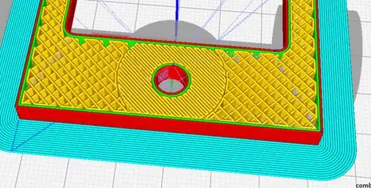

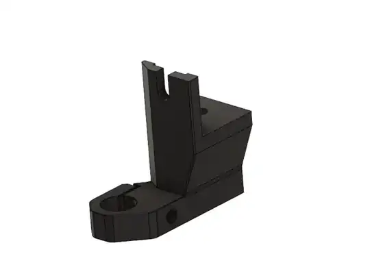

Please find below another example of a simple bracket that has extra cylindrical objects loaded to create the intersections with the bracket at the fastener holes. In the example, the infill at the fastener holes is set to 99 %.
Example of local 99 % infill at bracket fastener holes
After slicing, you will see that the infill at the intersections is adjusted accordingly.
Detail of sliced bracket showing local infill percentage
Note: I've tested this in Ultimaker Cura 3.4.1, and confirm it works. I sliced a part with the inserts for fasteners and it actually is not very difficult, it just requires a little more work. You will have to make some STL's of cylinders and position them correctly. If you make your own 3D models it will be a very easy task to add extra components while you design, positioning will be a lot more easy then (as they align with your model). An example is the following linear Z rod bracket of a Hypercube Evolution CoreXY printer, this bracket requires local reinforcements for the bolts clamping the bracket onto the aluminum extrusion profile:
Inserts are modeled together with the development of the bracket:
When combined, it looks like this:
Now the infill can be modified locally to 100 % to increase compression strength.

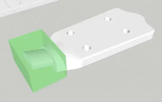

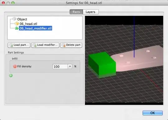

The blog describes the use of a simple volume (the green volume loaded from an STL file). After loading:
Right-clicking on the main part brought up the object settings menu. From there, clicking "Load Modifier" and selecting the previously saved model adds it to the part as a modifier.
The green "+" was selected and "Fill Density" was added to modifier list and set to 100 %.
Part with box for alternative mesh infill
enter image description here This shows that the functionality in Slic3r is very similar to the functionality in Ultimaker Cura.

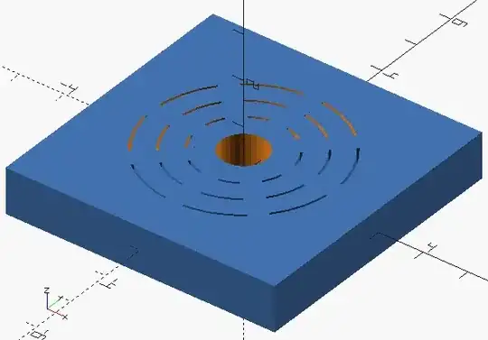

While you definitely can do this with custom slicing settings, if the "infill" is a design constraint necessary for the part to properly function, I prefer making it a part of the design rather than leaving it as something you can mess up at slicing time. This is particularly important if you will be sharing the design for use by others or using a 3D printing service that might not give you sufficient control over the slicing parameters. Moreover, when you say you want "higher infill" in particular parts, this is often an imprecise way of conveying what you really need, which is particular infill structure - usually additional walls - not just a denser version of the infill pattern.
To use your example of points that need to accept screws (either drilled/tapped after printing, or with printed threads), just having denser infill in that part of the print won't help unless it's 100%; drilling into infill pattern will not give you something solid that a screw can thread securely into.
What I do for things like this is create internal gaps in the model, narrower than the minimum clearance needed to avoid walls bonding to each other. For example, cutting out concentric cylindrical surfaces can make a great solid region to thread a screw into. As noted by Trish in a comment, 0.05 mm seems to be a good choice of gap width that's below the clearance needed for FDM printers to avoid bonding, but large enough not to get removed by slicing tools.
If you want to ensure the model is still logically one connected component, leave some gaps in the cut, something like:
reinforced hole model in openscad

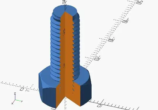

There's a lot of room for experimentation with exactly what kind of gaps work best. As Trish suggested, varying the location of bridges between layers may help. Adjusting spacing based on expected extrusion line widths may also be a good idea. One approach i've used in strengthening bolts, that might also work for threaded holes, is repeating the inner and outer thread profiles as a gap in the model. Here's an example cut to show the gap:
bolt with 60 degree part cut away to show reinforcement in head
This particular reinforcement is mitigating the fact that roofing above infill is only supported by the infill, and thereby is able to sag slightly, preventing the layers from bonding as strongly and preventing the threaded walls from bonding strongly to the head.
    a note about the wideness of these "slots" would be good. I had results with ca. 0.05 mm working. Also, it might be better not to line up the bridges but turn each ring a little to the one before into the direction of the threads. That seems to transmit the forces better to prevent shearing free. – Trish Feb 11 '20 at 18:09
  • @Trish: Indeed, there are lots of advanced variations possible. I've actually used a clone of the internal and external thread profiles turned slightly. But I wonder if clean integral number of walls (vs zigzag fill here and there) isn't more beneficial. I haven't done sufficiently rigorous tests to know yet. – R.. GitHub STOP HELPING ICE Feb 11 '20 at 20:05
    @Trish: I updated the answer with your suggestions and a good bit of new material based on my comment. – R.. GitHub STOP HELPING ICE Feb 11 '20 at 23:16

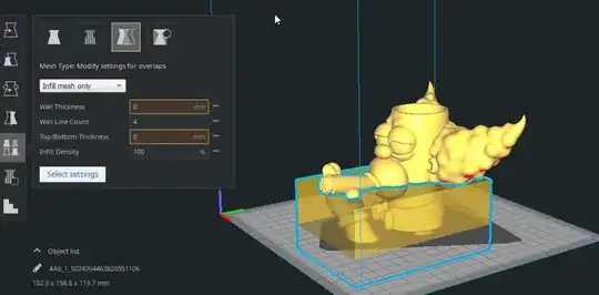

Using Cura 4.8
https://puu.sh/HuLkR/085842df24.png
5% infill
This is the Support Blocker button:
Drop anywhere on bed, then resize and move like any model, make sure to turn off uniform scaling
With support blocker selected, then click the Mesh Type button:
Mesh Type button
  • Modify settings for overlaps
  • Select settings
  • Type infill in the search
  • Select infill density
https://puu.sh/HuLAu/926ffa4208.png
Infill density has now been changed to 100% for selected part only.
