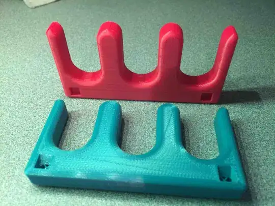

I have an object that has cutouts in it (alignment pins fit in the cutouts). The shape of the hole is a right triangle with the point clipped off to create a flat surface in the deep part of the hole.

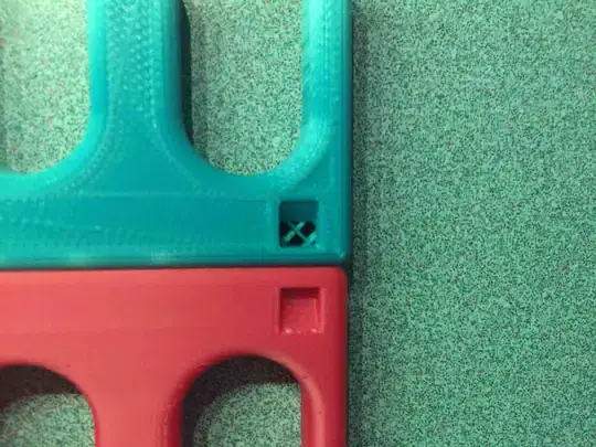

When I print the object in vertical orientation the wall in the deepest part of the cutout is printed properly. But when I print the same object laying down flat on the build plate, the internal wall is not printed and I can see the infill grid through the hole where the wall is supposed to be.
I sliced the object with a slicer based off a recent Cura version. I'm using the same STL to print the object vertically and horizontally.
Why is this occurring? Is there anything I can do about it other than printing vertically? (Because I have a need to print the real part horizontally. The part shown here is just a thin test piece.) Thank you Same object showing vertical / horizontal printing orientations The horizontal print position does not print the inner wall of the hole

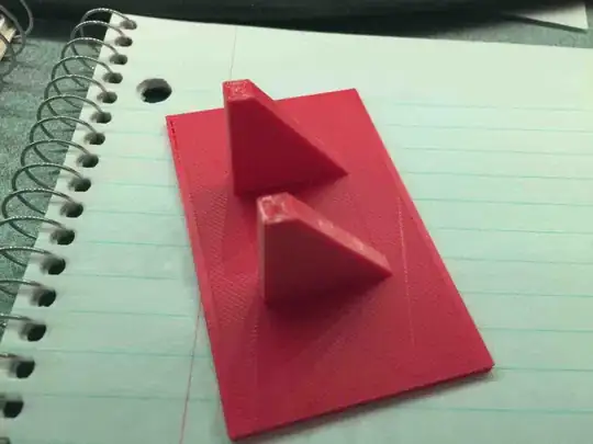

Here is a large-scale picture of what the cutout shape looks like. This picture is of the protrusion tab that fits into the hole. But the same shape was used to cut the hole in the object.
The shape used to cut the hole

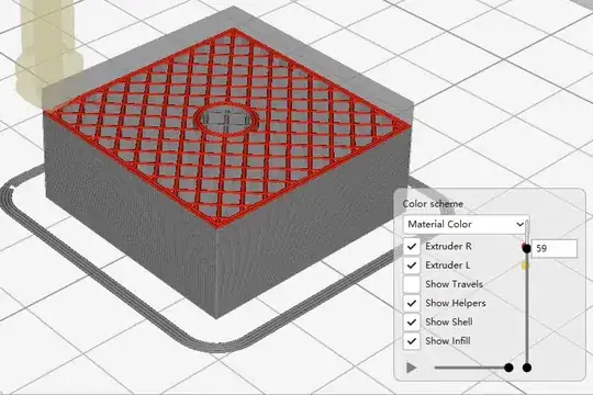

Here is another instance of the same problem. This time, I made up a simple block component, a simple cylinder component, aligned the cylinder into the block volume, and did a combine/cut operation in Fusion to cut a hole in the block (visible in the STL file). As you can see from the (Cura-derived) slicer layer image below, the same problem exists - no wall at the back of the cut when printing in the horizontal position. If I draw a sketch on the block and extrude/cut into the block, I get the same results. I also tried cutting the cylindrical hole, creating a "tin can" shell cylinder with an explicit bottom-of-the-can surface, sliding the open can into the cut hole, and joining the can to the block. Same results. The explicit bottom 0.5 mm surface of the can disappears in the horizontal slicing position. Strange.
Simple cylinder component used as a cutting tool to cut into a block shows the same missing back wall problem.
