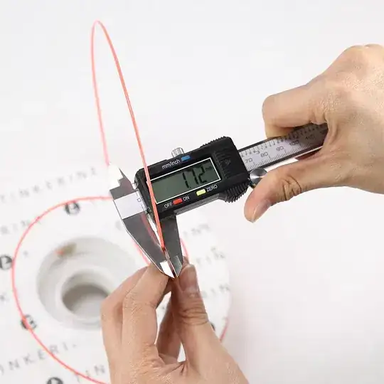

A first thing to check when under or over-extrusion is encountered for a fresh spool of filament on a normally good working printer is to check the diameter of the filament with a caliper (see image below) and change this value accordingly in the slicer software of your choice and make a test print. If the problem persists or is present from the start of your purchase or build, please proceed. Note that there are two ways to change the extrusion, a simple solution is changing the extrusion multiplier in the slicer software, the better one is to fix the extrusion rate in the firmware.
Please note that you should measure the filament diameter at several positions

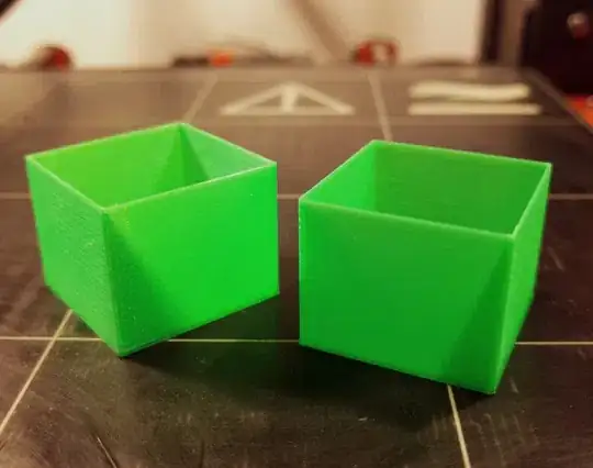

Although the extruder may now be correctly tuned to extrude exactly the amount as instructed, the slicer may have a different view. Be sure to set the slicer extrusion multiplier to 1.0 when fine tuning the extruder/slicer combination. The ultimate fine tuning starts with printing an object with zero bottom and top layers and a single perimeter with a fine layer height (0.1 or 0.15 mm).
Measure the thickness of the wall and adjust your slicer extrusion multiplier accordingly.
Now your extruder and slicer should be optimally fine-tuned!
