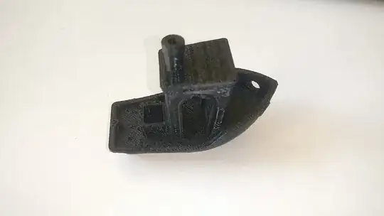

Here are images of 2 of the benchy's I printed. I stopped one of them half way through. The other one was my first print and the print speed was way too fast. I also did another print with slower settings but I can't find that one right now (that one was kinda stringy). A failed benchy I printed

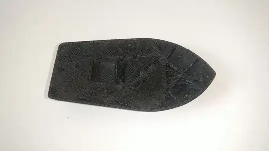

My first benchy (the print speed was a little too fast)

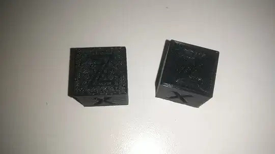

So, today I did a lot of testing. And I concluded that when I just insert some fillament into the printer and it hasn't reached the nozzle yet, it extrudes the right amount, but when it reaches the nozzle it just extrudes a lot less. So it seems to be a mechanical problem. I can change the extrusion command to actual extrusion ratio by extruding slower or by increasing the heat of the nozzle. But I have to go quite slow G1 F50 E50 to get anywhere near the right amount of extrusion (still a little more than half a cm short in this case). I did some test prints and it definately seems to make a difference to print slower. These cubes were printed with the one on the right being printed at a little less than half the speed as the one on the right.

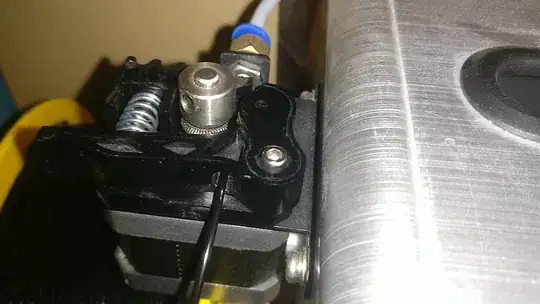

The printer is using one of those extruders where the fillament is fed into a tube leading to the nozzle.
The round thingey seems to be turning but it doesn't seem to grip the fillament well enough.

  • Nice update! Does the stepper motor of the extruder have a flat surface on the shaft? The photo does not seem to show that. The extruder gear grub screw needs to grip on the flat spot of the shaft. If it does, make sure the spring exerts enough pressure, possibly increase the spring tension. – 0scar Apr 15 '20 at 04:41

Note that a Benchy is a nice, well known print, it actually isn't a good example to calibrate the printer; it is preferred to print calibration cubes, preferably the ones with embossed X, Y and Z.

The prints show severe under extrusion. Note that 50 (in the slicer, extrusion rate) means 50 %, this should be 100 %. Basically, you tell the printer that it may only use half the amount of filament it needs to print the object. Furthermore, when you command 100 mm to be extruded, the actual displacement of filament also need to be 100 mm. See "How do I calibrate the extruder of my printer?".
