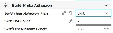

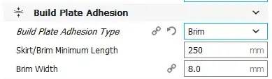

To some degree, this behavior can be avoided by adding a skirt of a certain length. An equally good alternative that also increases bed adhesion for tricky parts is the brim. Both are not set via G-code but can be added by the slicer. In Ultimaker Cura both are found in the tab Build Plate Adhesion as type, as the following pictures show:
Skirt: 2 lines, minimum length 250mm

Brim: minimum length 250mm, 8mm width

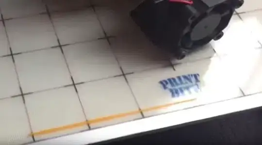

This resulted in a nice line like this: A printed "Prusa Priming Line"
In Ultimaker Cura, this piece of code is added via the preferences of a machine. In Cura 3, you usually had to add the starting G-code yourself. Since at least version 4.2.1, all preset machines contain some variant of a priming line, usually at the left side.
