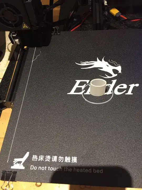

I recently got a Creality Ender-3, and tried printing a few things for some tests. I’ve printed a cube and just printed a cylindrical tube today, and I notice each time, it adds this random line on the left and a sort of outline around the actual print. Neither of these were there in my Cura file, but they’re always printed and I’m not sure why?

Left line = Priming
The straight line on the left is typically used to prime the printer nozzle to get the filament flow starting, this is typically seen in PrusaSlicer (Prusa's fork of Open Source toolpath generator for 3D printers Slic3r). This straight line is called priming line, purge line or intro line, and is typically (but not necessarily) printed outside or at the edge of the bed area. Furthermore, a prime line print routine will catch errant nozzle ooze, test extrusion (it is the first indication if the nozzle to bed distance is correct; if not you can abort with minimal material loss) and perform a final wipe action to avoid stringing between the prime line and start of the print. Note that this straight prime line is not a standard option in a custom profile of Cura, so this was part of the Ender-3 Preset you imported or possibly you have copied a starting G-code that includes this prime line.
A typical set of G-code lines to create a prime/purge/intro line is found in your start G-code and could look similar to:
G1 Y-3.0 F1000.0 ; go outside print area
G92 E0.0
G1 X60.0 E9.0 F1000.0 ; intro line
G1 X100.0 E12.5 F1000.0 ; intro line
G92 E0.0
After slicing your object, you will find such lines in the generated G-code file, but they are not displayed in the preview. Further information can be found in Writing G-code : swiping at start of print

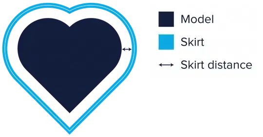

Equidistant line = Skirt
The lines at distance from the print object is called the "skirt", the skirt is an option found under the "Build Plate Adhesion" options in your slicer. The function of the skirt is similar as described for the straight prime line, but it has additional effects that can be wanted. It also shows fairly fast if the bed is unleveled as a whole or if the bed is greasy. Please look into: "What are main differences between rafts, skirts and brims? ".
Note that it is usually superfluous to use both the prime/purge/intro line and the skirt, both have a similar function. The benefit of the skirt is that you can configure it within the slicer (e.g. length of the printed skirt, height to use as a shield for draft or ooze and distance to product). The downside is, that a skirt limits the useable build area by the distance and width of the skirt.
The outline around the actual print is called Skirts. and the random line on the left is called intro line it's not necessary you need both Skirt and intro line. The intro line can disable from custom starting gcode settings

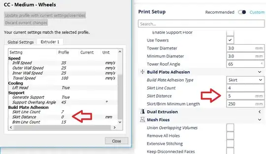

A skirt is an outline that surrounds your part but does not touch the part. The skirt is extruded on the print bed before starting to print your model. Skirts serve a useful purpose because they help prime your extruder and establish a smooth flow of filament. Observing the skirt also allows you to detect and adjust any leveling or adhesion issues before the actual model begins printing.
You can easily edit/disable(not recommended) those settings in Cura (or in any slicing software) In you Cura navigate to Build Plate Adhesion settings
  • Skirt line count: The number of skirt lines printed around the model.
  • Skirt distance: The distance between the model and the skirt.
  • Skirt minimum length: The total length of the skirt. This will override the skirt line count when the minimum length is not reached yet.

The line off to the left is the "priming line"; the printer is extruding a bead of material to ensure that any oozing is cleaned off of the filament tip, and that the filament is properly pressed into the hotend and flowing consistently from the nozzle, before beginning your print. Notice how plastic didn't start extruding on the "backstroke" until the extruder had almost reached the back of the plate? If you didn't have that priming line, that material would have been missing from your print's first layer.
The ring around your print is the "skirt". The skirt also helps to prime the extruder, and allows you a quick look at your first layer printing behavior before the printer begins printing your actual part. Is your build plate level? Is the nozzle clearance correct? Is the filament adhering well to your bed prep? Are your build plate size and offsets set up properly in the slicer (or are you about to try to print off the edge of your plate)? A skirt can help you determine all these things very quickly, like before the printer starts working over the actual print area, giving you a chance to correct them on-the-fly or at least quickly cancel the print, and it uses a minimum of material to do so compared to a more substantial plate adhesion aid like a brim or raft.
