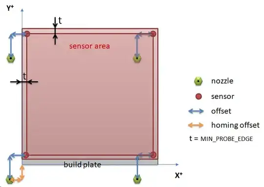

In the following images, the nozzle, the sensor and the offsets are defined by: Legend of nozzle, sensor and offset

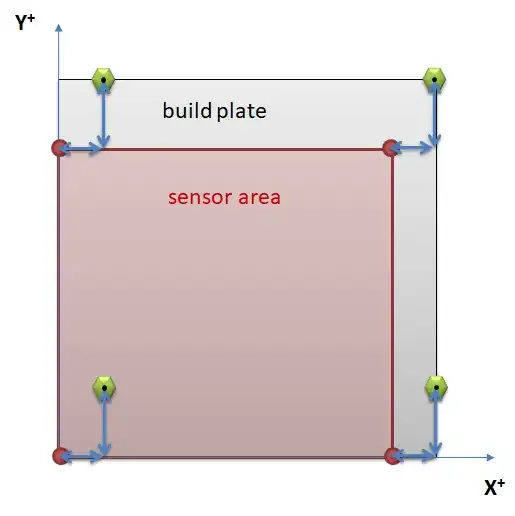

1. Sensor at the back-right:
Probe area for back-right probe
This implies that the sensor can reach the back and the right borders, so the limits are set by:
#define LEFT_PROBE_BED_POSITION (X_PROBE_OFFSET_FROM_EXTRUDER)
#define RIGHT_PROBE_BED_POSITION (X_BED_SIZE)
#define FRONT_PROBE_BED_POSITION (Y_PROBE_OFFSET_FROM_EXTRUDER)
#define BACK_PROBE_BED_POSITION (Y_BED_SIZE)

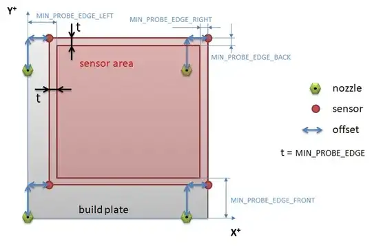

Note that if a minimum probe offset is defined by #define MIN_PROBE_EDGE [value] in the configuration (to account for sensor width/dimension), the bed limits are changed resulting in (where t = MIN_PROBE_EDGE):
Probe area for back-right probe with MIN_PROBE_EDGE offset
Limits are then set by:
#define LEFT_PROBE_BED_POSITION (X_PROBE_OFFSET_FROM_EXTRUDER + MIN_PROBE_EDGE)
#define RIGHT_PROBE_BED_POSITION (X_BED_SIZE - MIN_PROBE_EDGE)
#define FRONT_PROBE_BED_POSITION (Y_PROBE_OFFSET_FROM_EXTRUDER + MIN_PROBE_EDGE)
#define BACK_PROBE_BED_POSITION (Y_BED_SIZE - MIN_PROBE_EDGE)
In the following sensor position placements, this offset for MIN_PROBE_EDGE will be accounted for.

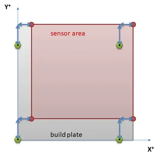

2. Sensor at the back-left:
Probe area for back-left probe
This implies that the sensor can reach the back and the left borders (for zero MIN_PROBE_EDGE), so the limits are set by:
#define LEFT_PROBE_BED_POSITION (MIN_PROBE_EDGE)
#define RIGHT_PROBE_BED_POSITION (X_BED_SIZE  + X_PROBE_OFFSET_FROM_EXTRUDER - MIN_PROBE_EDGE)

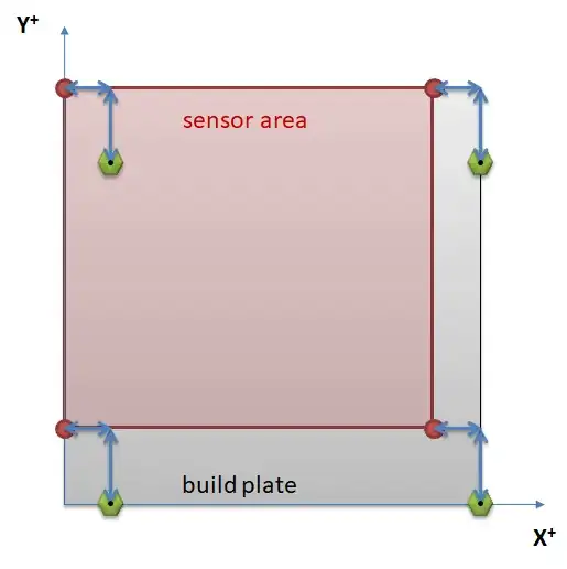

3. Sensor at the front-left:
Probe area for front-left probe
This implies that the sensor can reach the front and the left borders (for zero MIN_PROBE_EDGE), so the limits are set by:
#define FRONT_PROBE_BED_POSITION (MIN_PROBE_EDGE)
#define BACK_PROBE_BED_POSITION (Y_BED_SIZE + Y_PROBE_OFFSET_FROM_EXTRUDER - MIN_PROBE_EDGE)

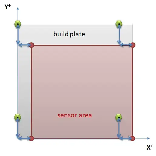

4. Sensor at the front-right:
This implies that the sensor can reach the front and the right borders (for zero MIN_PROBE_EDGE), so the limits are set by:
