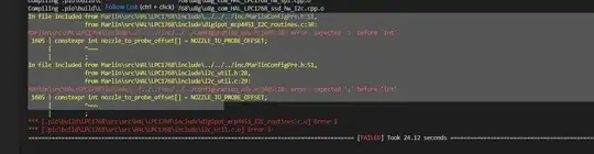

update: error message on compiling enter image description here Config.h : https://pastebin.com/w7CC5eaC Config_adv.h : https://pastebin.com/qep34T1h
You do not need to adjust the area yourself for Marlin 2.0, please look into probe.h and into this answer.
You only need to enable the offsets:
#if PROBE_SELECTED && !IS_KINEMATIC
  #define MIN_PROBE_EDGE_LEFT MIN_PROBE_EDGE
  #define MIN_PROBE_EDGE_RIGHT MIN_PROBE_EDGE
  #define MIN_PROBE_EDGE_FRONT MIN_PROBE_EDGE
  #define MIN_PROBE_EDGE_BACK MIN_PROBE_EDGE
#endif
