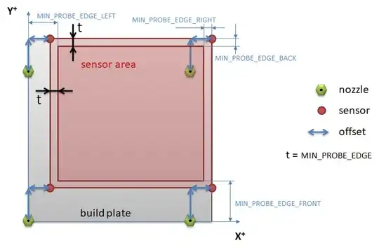

Following the theory from this answer the probe is only allowed to visit the following (dark red) area:
Probe area for back-right probe Marlin 2.0.x
This area is defined as:
  #define MIN_PROBE_EDGE_LEFT (PROBE_OFFSET_X_FROM_EXTRUDER + MIN_PROBE_EDGE)
  #define MIN_PROBE_EDGE_RIGHT (MIN_PROBE_EDGE)
  #define MIN_PROBE_EDGE_FRONT (PROBE_OFFSET_Y_FROM_EXTRUDER + MIN_PROBE_EDGE)
  #define MIN_PROBE_EDGE_BACK (MIN_PROBE_EDGE)
which translates to:
  #define MIN_PROBE_EDGE_LEFT (25 + MIN_PROBE_EDGE)
  #define MIN_PROBE_EDGE_FRONT (55 + MIN_PROBE_EDGE)
As seen in the commented //#define MIN_PROBE_EDGE_LEFT 5 and uncommented #define MIN_PROBE_EDGE_LEFT MIN_PROBE_EDGE (equals 10) left probe limits, you are at least respectively 20  or 15 mm short, hence the sensor is not on the plate on the left.
