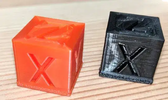

I have an Ender 3 that I have been pretty happy with so far, however it recently started an odd behavior and I can't figure out what's causing it.
What happens is that the first ~3 mm of the print comes out "sloppy". After that, everything clears up and it prints fine for the rest of the print. (Although it perhaps looks a little under extruded on the top layer)
It looks almost like it's over extruding. But if that's the case, why would it only be for the first 3 mm? Then the top layer looking under extruded makes that possibility even more unlikely.
This is consistently happening regardless of what I am printing, the brand of filament (I only print PLA), or the bed temp or hot end temp. I've tried tweaking with the bed leveling and giving a little more gap on the first layer, but that doesn't seem to change anything either. I also calibrated the extrusion multiplier and it's spot on now.

Update: I did some slightly more controlled experimemts and I did get it looking a little better. It does seem related mostly to bed tempurature. The cooler I make the bed, the better it looks. However as it gets cooler, the prints are also starting to warp and break loose, so the print ends up failing completely. I had a hard time getting a successful print below about 45 degrees, and even at that temperature it still isn't completely clean. I'm using glue stick for adhesion and it just doesn't seem able to hold it without some heat. I traditionally have run around 50 degrees before this problem started though, so it seems odd I have to drop below that now.
Also, for more info, the cube dimensions are pretty close in the X and Y, but were about .5mm short in the Z. So the layers do seem to be settling.
I did check the bed temp with a non-contact thermometer and it was consistent with what the printer reported, so it doesnt seem to be a bad thermostat throwing things off.

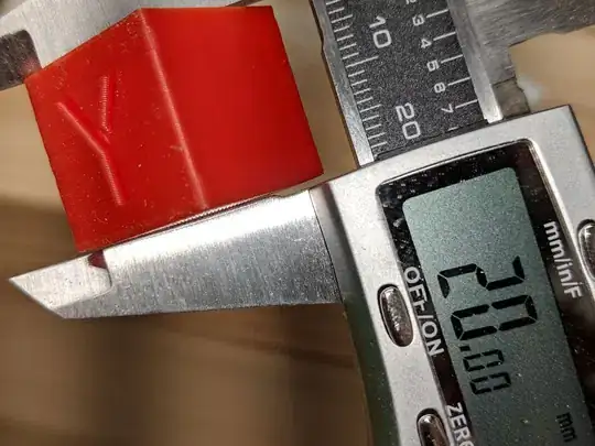

Measuring the calibration cube
I suspect what was happening is that the rollers were too loose and at certain heights they we allowing movement in the Z axis. Perhaps there is a flat spot that was allowing the X rail to droop, then once it got past the flat spot it would print cleanly again.
I haven't printed anything tall enough yet to see if the bad layers still show up higher in the print, if they do, I think it is probably a sign that I need to replace some rollers. In the mean time, I'm thrilled to be getting decent prints again!
