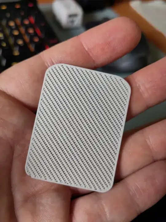

The raft prints perfectly:
Photo of a printed raft

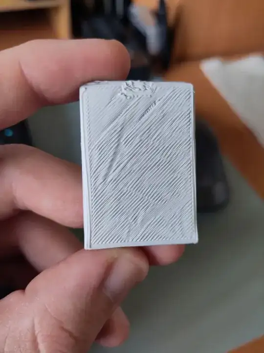

Then when it starts the first few layers of the actual print it extrudes a bit of material which then hangs from the nozzle and is dragged about the surface of the raft before stopping as more material is extruded. So when the print finishes the first layer looks messy like the one below:
Photo of the first layer of a printed model showing printing errors

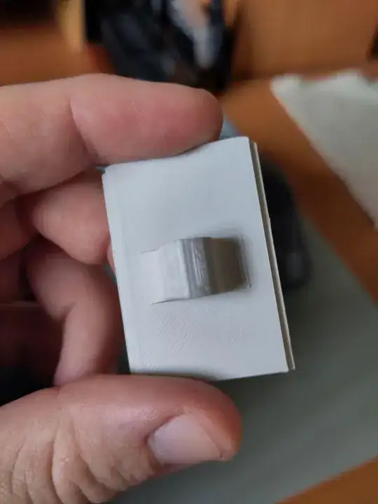

But everything after the first few layers is perfect for example the top of the same print:
Photo of the layers after the first of a printed model that doesn't showing any errors

    The bed temp is fine at 60 °C, even down to 40 °C. As you are getting a nearly perfect first layer on your raft, you could consider to begin the print without a raft, perhaps only a skirt or brim with which to prime the nozzle. I'm not a Cura user, which prevents me from identifying which setting might be affecting the raft/first layer interface. – fred_dot_u Jul 17 '22 at 18:41

It seems to me that the problem is over extrusion. Those temperatures might be a little high for this PLA. In my settings I usually put it on 200 or 205 °C (when printing faster). But the real problem might be a wrong extrusion multiplier for the first layers or a mixed with temperature, low speed, or no retraction.
My advice:
  1. Try a little bit lower temperature
  2. Try reducing the first layers extrusion multiplier
  3. Try increasing the retraction a little bit
For the problem of not extruding plastic at the beginning, you should print a purge line (as Ender 3 does) or print a skirt (instead of a raft, that you might not need). This problem is very normal and is easily fixed.
The bed temperature is correct for PLA (60 °C). Maybe, only maybe, your nozzle is a little bit high. It should squash the plastic on over extrusion, which I think is not happening in your setup. My advice for this is to use a paper sheet and fold it once.

Hi Thanks for all the suggestions. I've been experimenting with various prints using some of the different settings and it appears that I needed to increase the initial layer height. Now the first layers are printing as they should.
