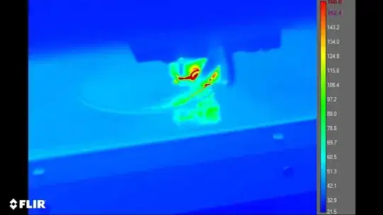

a thermal image of a 3D print
Well, heat transfer bases, roughly speaking, on a formula like this: $Q = mc\Delta T$ Q is the thermal energy of the object, m the mass of the object, c its specific heat capacity and T the temperature, ΔT the temperature change. But we don't have a homogenous object, we got pretty much a heat distribution with touching zones of different heat. The actual formula for the heat transfer inside the object is a long mess containing stuff like the gradient $\text{grad}T$, thermal conductivities, and integrals, but what matters is the result: The faster-expanding line of filament loses a little less thermal energy to its surroundings than the less forceful extruded line, which can increase the bonding between the two as the temperature on several fronts:
  • it enters the crevices further before reverting from goo to solid, leading to better adhesion for more surface.
  • it contains more thermal energy that can and will get transmitted to the layer below and has a bigger surface area, so it can increase the zone thickness that gets remelted a tiny bit, increasing the layer bonding strength a little.
This can result in a problem though: if you don't give the printed lines enough time to cool, it can lead to the material to accumulate heat more and more, leading to the whole thing to melt and turn into goop. An easy fix to this side problem is minimum layer time. But that would be only tangential to the original question, so look for example at the question here or the video the thermal picture above is taken from here.
