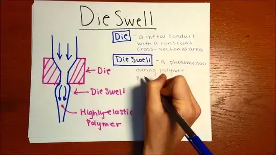

This question has a relation to "Why is it conventional to set line width > nozzle diameter?". This answer on that question addresses a phenomenon called die swell to explain that the extrusion width is generally larger than the nozzle diameter even if the line width in the slicer is set to the nozzle diameter. Basically, increasing the line width increases the extrusion multiplier, so why not set that directly?
Die swell explained
