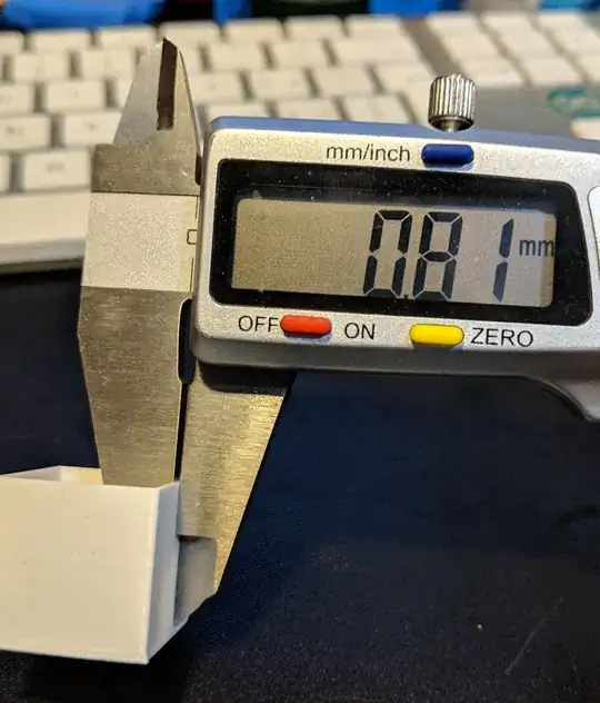

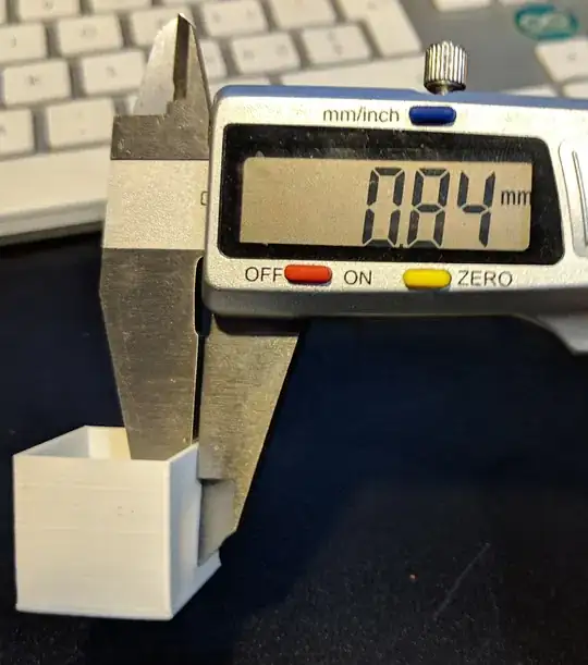

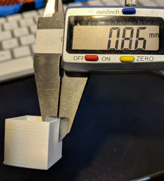

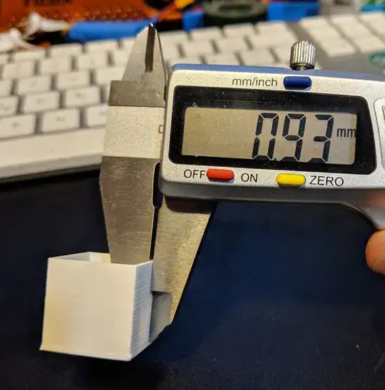

I calibrated my extruder according to the mattshub tutorial and printed the extruder calibration test cube with 2 perimeters of 0.4 mm. So the walls should all be 0.8mm thick but only 3 are close to 0.8mm and one is about 0.93 mm thick. The pictures are one turn, walls following each other are side by side:
Thick wall thin wall Average Wall 1 Average Wall 2

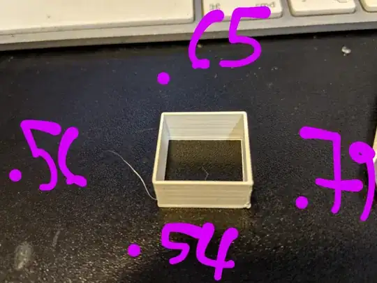

Update 1
I printed a solid, smooth calibration cube with 1 Perimeter of 0.45 mm, 0 top/bottom layers and 0 % infill, as suggested and got 0.56 mm, 0.65 mm, 0.79 mm and 0.54 mm
The results: 0.56/0.65/0.79/0.54
I believe that the thickest side is the one where the layer ends and retraction is done in the corner before layer change. Maybe retraction settings?

Let's Troubleshoot!
You might not have calibrated the extrusion multiplier correctly, or the steps/mm might be off, or other print settings shoot us way off. Let's make sure to find the source.
Filament extrusion multiplier
  • use a solid cube as a base, for example, https://www.thingiverse.com/thing:38108
  • set line width to 0.45 mm to counteract errors from die swell and get a better print result in general1
    • $d_\text{line width}=0.45\text{ mm}$
  • set the number of walls/perimeters to 1
    • $p=1$
  • set infill to 0%
  • set top layers to 0
  • set the extrusion multiplier to 100 %
  • print the cube (or half of it, Z-height does not matter too much) with no top and infill and 1 perimeter
  • re-measure the walls
Done that? Math time to calculate the correct multiplier for the filament! The average wall is easy:$$d_\text {average}={\frac{\sum_{i=1}^4 d_i}{4}}$$ $$\frac{d_\text{line width}\times p}{d_\text {average}}=\text{Extrusion multiplier}$$ Remember, that the result is not in % but a float point number! 1 is 100%. So you fill in that value times 100 into the extrusion multiplier.
After this, repeat the whole process with 2 perimeters.
1 - further reading: Why is it conventional to set line width > nozzle diameter? & Slicer line width vs. extrusion multiplier for layer adhesion?
Steps/mm
Make sure to test the extruder against the heated extruder, then repeat the calibration as your tutorial explained.
For some tests, let's fudge to some degree: Trying a filament dependant value of steps per millimeter can help to try to find other sources of errors easier - it makes them at times more pronounced. So we just multiply our steps/mm with the extrusion multiplier that we calculate the way outlined below. For 428 steps/mm and the numbers from Update 3, this gives about 306 steps/mm. This is not a proper calibration, but a means for troubleshooting. After fudging with the parameters reset the extrusion multiplier to 100%, we just want to check what influences our thickness.
