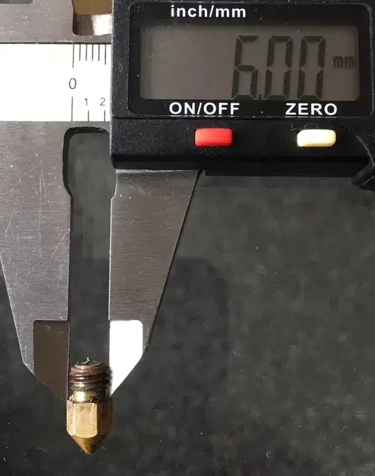

The Ender 3 takes an M6 thread (metric 6 mm diameter). Measurement of stock nozzle shown.
Most sellers will list compatible printers Ender 2, Ender 3, Ender 4, CR-10, CR-10S, CR-10 Mini, CR-10-S4, CR-10-S5, CR-8, CR-7. Will Also Fit Any Other MK10 Heater Blocks.
I recently bought some titanium alloy nozzles as the brass one got closed over after crashing into the glass bed.
Measurement of nozzle in digital calipers

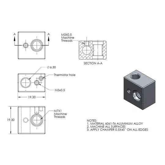

There is no such thing as a single MK10 hotend design. The Chinese aftermarket has mingled the designations.
If it has a MK10 like Makerbot hotend, then the nozzles you are looking for are M7 threads. It appears (see this answer) that your hotend is a cloned MK10 and has different dimensions, you have the M6 version.
Quote from link above: (this is about the Makerbot MK10)
MK10 was a complete change of the hotend. MK10 uses smooth OD thermal barriers with a larger 4mm OD 2mm ID PTFE liner. MK10 also uses M7 threads, vs the M6 of all previous models. This is because a 4mm PTFE liner is barely enough metal to make the outer tube with m6 threads. MK10 is completely incompatible with all previous hotend parts. Every part is different. Mk10 still uses MK9 feeder parts.
You could measure your current heat block (the width of the Aluminium block); if you look at the MK10 drawings of a proper M7 MK10 Makerbot (or derivative) hotend (below) you see that the width of the block is about 19 mm (which would be the length of the heater cartridge).
MK10 Aluminium heater block dimensions

  • Where did you get the diagram? The ender 3 is a MK10 hotbed but it is an M6 thread. Not M7. – Gone Coding Nov 06 '18 at 15:00
  • @GoneCoding A true MK10 (invented by Makerbot) has these dimensions, if not it is a different MK10. – 0scar Nov 06 '18 at 15:16
    Thank you very much! You are also correct, I need the M6 nozzles and the 20mm cartridge! – iamroot Nov 07 '18 at 12:20
    @iamroot There is a lot of confusion, as there are more MK10 designs around. See e.g. the [difference between an MK8 and an MK10 nozzle](https://www.google.nl/url?sa=t&source=web&rct=j&url=%23&ved=2ahUKEwjxqsLarsLeAhUK1hoKHWJvAN0QwqsBMAF6BAgJEAo&usg=AOvVaw0VTJzWxrN8ZFOD4xbU2nov). – 0scar Nov 07 '18 at 13:22
