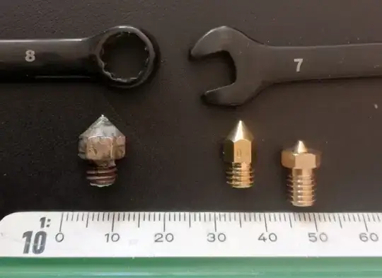

For comparison, take a look at this photo, where I aligned the lower ends of the bodies to line up under the wrench needed to handle them.
Chinesium Big, Small and e3D styles
In words, left to right:
  • Chinese Big M6 Nozzle
    • size 8 metric wrench, 4 mm thread length, 1 mm clearance, extends a minimum of 8 mm from the heater block
  • Chinese Small M6 Nozzle
    • size 7 metric wrench, 4 mm thread length, 1 mm clearance, extends a minimum of 8 mm from the heater block
  • e3D v6 normal (aka NOT volcano etc)
    • size 7 metric wrench, 6 mm thread length, 2 mm clearance, extends a minimum of 5 mm from the heater block
