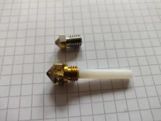

I have a Monoprice Maker Ultimate 3D Printer and have tried to replace the nozzle.
The nozzles I bought turned out to be too small.

What are the important specifications of a nozzle?
  • Thread size
  • Thread length
  • That plastic tube thing?
Monoprice is very bad at publishing the specs, can I work it out with a caliper?
BanksySan
  • 520
This is a so-called MK10 nozzle, it is larger than the normal nozzles you find (as you found out).
There are quite a few questions on this nozzle, with e.g. this answer or this answer.
This nozzle uses M7 (metric threads of 7 mm) to have more room to fit the PTFE tube (white tube) in the nozzle itself. This tube forms the barrier between the heating source and the filament feed so that it does not melt too soon. You can find these nozzles on those typical auction websites by searching for "MK10 and M7".
When you have ordered the correct nozzle you could reuse the existing PTFE liner if it has not degraded or damaged, or buy replacement PTFE tube of 4 mm outer diameter and 1.9 or 2 mm inner diameter and cut a similar sized replacement liner.

  • Maker Select, Select V2, and Plus are Mk10. I thought Ultimate was Mk11? – Joel Coehoorn Mar 29 '19 at 21:55
What part fits?
A replacement nozzle needs to fit 3 parameters:
  • Thread diameter and pitch need to match up, to allow mounting
  • Thread length should be close to the original to allow secure fastening
  • The style needs to fit: there are quite some styles of nozzle - most are not lined, yours is PTFE lined to the nozzle (see also Can the filament tube be outside of the nozzle?)
Monoprice nozzles are not compatible with what is known as Ultimaker Mk8 or E3D style (which you bought). They are Ultimaker Mk10 style.
