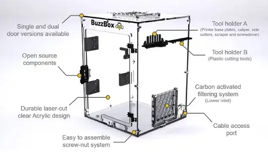

Best material for passive filtering is carbon foam. It has the ability to capture chemical fumes. See this filter comparison. Having an enclosure with such a filter would be a good start.
For example BuzzBox.

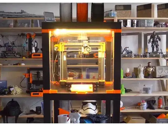

If you decide to build an enclosure on your own, take a look on Prusa's video on a DIY version build from Ikea table. There is no filtration system, but it should be simple enough to integrate a carbon foam with a ventilation.

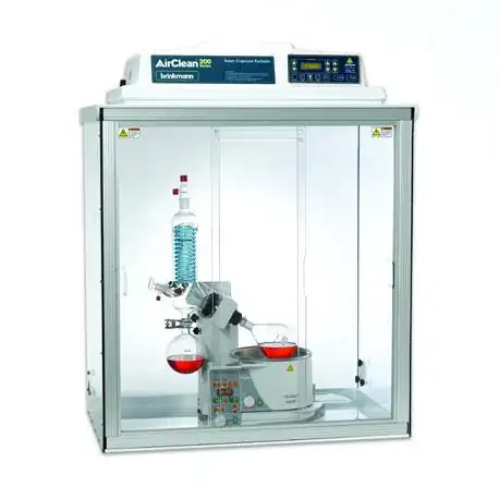

I have looked into this a lot. Especially when I had a phd chem engineer girlfriend who kept talking about how the fumes might give me cancer.. Frankly the system you need just costs too much. Lab equipment can run 20k easily. Not to mention the noise. What you really need is a backyard shed, but as one who lives where it snows I understand that is rarely a realistic option.
The Buzzbox looks cool and there are other brands. However their prices are usually as much as a flashforge, and usually cannot even hold a flashforge. More importantly there are parts where you can DIY your own. 300 for a plexiglass case that can only hold a mini printer is not good enough by far.

Taking that laser cutting fume extractor. There is nothing that will perform better than that. I hear you might get some smell, but that was in regards to laser cutters.

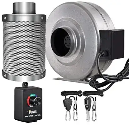

Anybody consider using a Grow Box Fan and filter inside an enclosure. They come cheap with 180 cfm fan and / carbon filters.
https://www.amazon.com/iPower-Inline-Variable-Controller-Ventilation/dp/B07D8TZ2KV/ref=sr_1_17?dchild=1&keywords=low+noise+grow+box+fan+kit&qid=1593395416&sr=8-17
Seems like it would work well, just wondering if they are really noisy.
