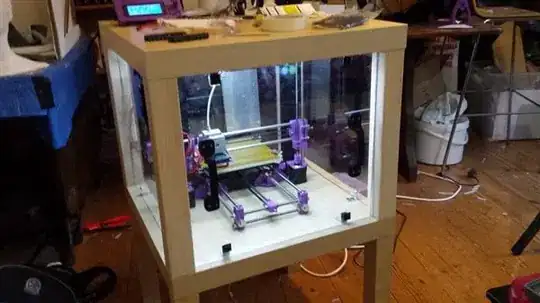

Note: After having stated that wood is not the best idea, it seems that IKEA tables are sometimes used, by stacking two on top of each other: New IKEA hack lets you create a 3D printer enclosure for cheap
IKEA table
Enclosed Prusa i3 printer

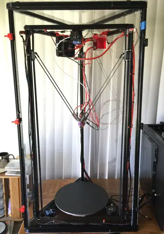

A safer bet is this delta printer enclosure, which is, essentially, a larger delta frame, made from aluminium extrusion and acrylic, enclosing a smaller delta printer: 4 Simple Steps to Build Your Own 3D Printer Enclosure
Enclosed delta printer

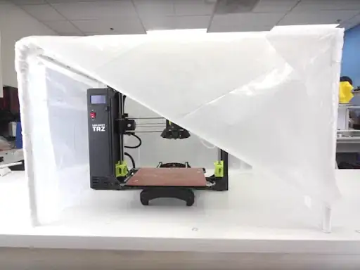

For an example of a cheap, yet extremely flammable enclosure, made from plastic sheeting and piping, see How to build an enclosure for your 3D printer
Plastic printer enclosure
