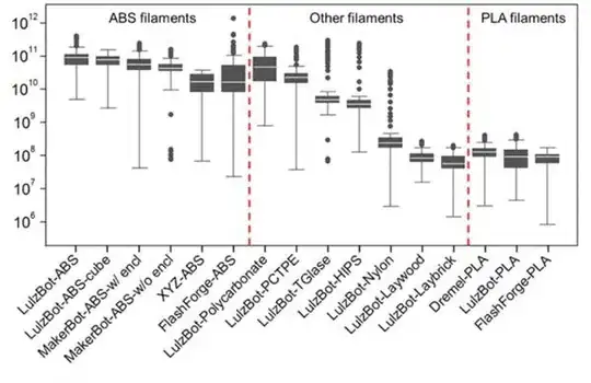

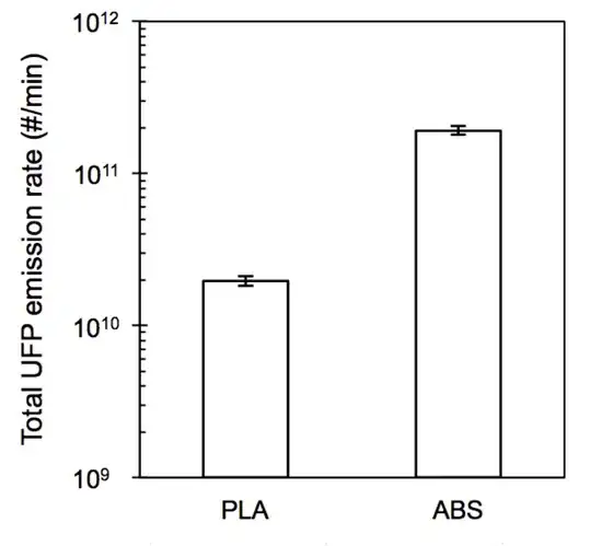

Lot of these have some scary looking graphs. Note that I am being a bit sarcastic when I say "scary looking graphs" the take away is ABS has twice the Fine Partical emission as PLA. However should you be worried, is still up to debate. The idea is that FPE can maybe contribute to cancer or other illnesses. FPEs are thought to irritate the lungs.
These graphs are of the ultra fine particle emissions.
as you can see PLA is MUCH safer in this regard.

1I am nearly offended at the "scary looking graphs" part. The graphs depict data, and that data has some interpretation. You can't tell whether something might be dangerous based on looking at graphs and saying "that looks scary!". You don't mention what the graphs depict (for the first graph, you haven't even listed the units of the vertical axis). According to the last graph, PLA emits 10 times fewer particles than ABS but I'm not sure how that justifies your "MUCH safer" claim. Perhaps the level of ABS is nothing to worry about to begin with, or even the level of PLA might pose a risk. – Tom van der Zanden Jan 21 '17 at 10:10
Fair point though try to not get offended by graphs haha. The issue is it's unknown exactly how dangerous but it is generally agreed that both pla and abs are dangerous. I think it's important to note that it's implied one should read the articles I posted along with the graphs I'll also point out both graphs are of the same measurement. Ultra fine particles – StarWind0 Jan 21 '17 at 17:13
“ABS has twice the Fine Partical emission as PLA” The graphs you posted are log scale. The second graph shows ABS having about 10x the UFP emission rate of PLA. In the first graph, the differences are in the 100x to 1000x range. – rob mayoff Sep 16 '18 at 20:14
