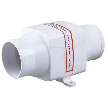

Squirrel-cage blowers provide powerful airflow but you may not need something as expensive as a laser cutter blower. A boat bilge blower might be sufficient to provide clearing airflow for your printer.
bilge blower
Additionally, a small bilge blower such as that shown above will use smaller diameter ducting, which would be easier to find and less expensive. The bilge blower in the picture provides for an in and out attachment, while the not-really-a-laser-cutter blower in the picture does not. A true laser cutter blower has ducting attachments for input and output.
