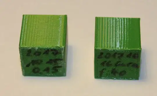

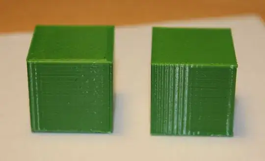

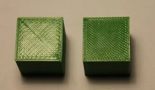

I've printed a 2x2x2 cm test cube with Slic3r (left) and Ultimaker Cura (right) and my Prusa i3 derivative machine with tight belts. The print settings should be quite equal (0.15 mm layer height, 40 mm/s outer wall speed, default accelerations/jerks). Though the top surface of the Ultimaker Cura-cube looks much better than the Slic3r-cube,
Left: Slic3er, right: Ultimaker Cura
the latter has much flatter vertical walls than the first.
Left: Slic3er, right: Ultimaker Cura Left: Slic3er, right: Ultimaker Cura
The front wall of the Ultimaker Cura-cube was printed from left to right which could explain the wavy result as some kind of vibration caused by the sharp y-stop at the left front corner.
But what setting could have influenced this? Should I try to manual setting of lower accelerations in Ultimaker Cura?

  • Looking at your last photo the cura print on the right. I see the waves on the top side of the cube to the right. This makes me think your infill/perimeter overlap is set too high. I use slic3r so 5% is my perfect number, but I don't know Cura well enough to find that setting. Lookup the infill/perimeter overlap equivalent setting in Cura and try to reduce that number and prevent the nozzle from overlapping too far to the walls. – Athanasios Karagiannis Oct 18 '17 at 21:23
  • I don't think that the waves are caused by infills because a) they are too small and b) they do not stretch across the complete vertical shell, but only at one side - always after the corner. – Thomas S. Oct 19 '17 at 05:37

This defect that you see is called "Ringing" and is described in detail here.
In summary, these waves are seen when the print head makes a sudden change in direction in combination with high speeds and high accelerations. As the waves dampen in amplitude the further you get from the sharp corner, this is related to print settings rather than vibrations transmitted through the belts.
Apparently, the settings for Ultimaker Cura differ from the settings in Slic3r, there is no other explanation as the hardware is exactly the same. Reducing print speed and acceleration in Ultimaker Cura will reduce the ringing defects.

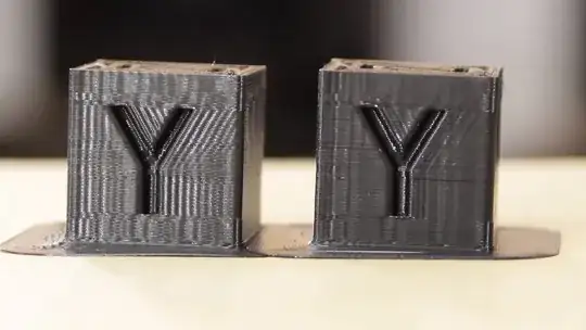

It is difficult to see with the lighting and the shiny green, but try printing a more complex object, like the usual XYZ cube. Does it look like this one? which means big waves after a change of direction, but then getting smaller?
If so, it is "ringing" or "ghosting", which means that the acceleration you set is too high for the mechanics of your printer and the machine vibrates too much.
Does it look like this one? Which means, exactly aligned vertically, and everywhere, not only after changes of direction?
Then it is NOT ringing, it is due
  • too tight belt (almost always!)
  • poor quality belt
  • poor bearings or idlers (not common)
I also had it and it was the belt, too tight. Loosen it, it can be much looser than you think before you get issues.
