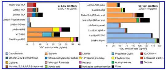

  1. Regarding emissions, the following recent report, Emissions of Ultrafine Particles and Volatile Organic Compounds from Commercially Available Desktop Three-Dimensional Printers with Multiple Filaments, indicates that PLA is a pretty low emitter (1/20th of nylon) and most of what it out-gasses is Lactide which is low on the harm scale. That said, everybody's nose sees things a bit different and people tolerate smells differently. Note also that we used to think lots of things (like asbestos) were harmless that we know differently now. Note also in the figure below from the report that all PLAs are not created equal. Dremel PLA produce way more nasty stuff than FlashForge PLA did. I am also sure additives, colorant, and fillers can change this a lot as PLA filaments aren't not all PLA.
