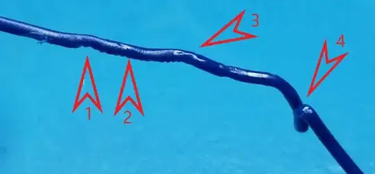

Fig. 1: Some typical signs of heat creep on the filament of a direct drive. 1) notch in filament where gear spins in soft filament. 2) normal teeth marks in filament. 3) soft filament bending. 4) soft filament bunches in open area. With a Bowden tube, the filament widens at the end.

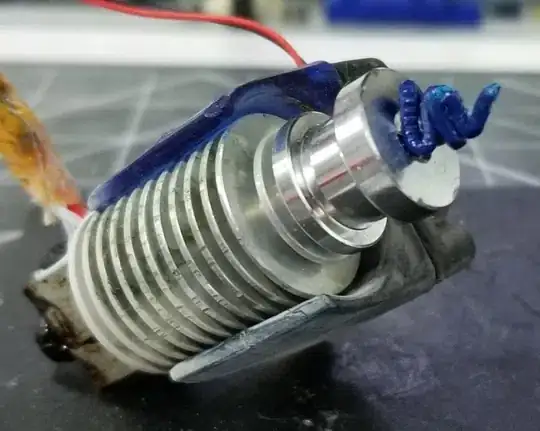

Fig. 2.: Another example of heat creep with a direct drive extruder.

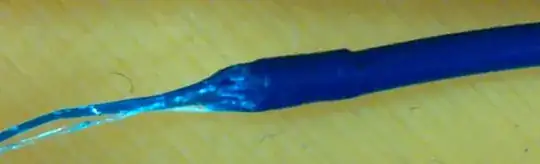

Fig. 3.: Filament with end expanded in nozzle showing jam from filament moving too fast and not heating enough.
