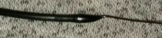

I determined I have the problem shown in figure 3 on this question. How I confirmed that is I started a print and monitored it closely. As soon as the filament stopped coming out I paused the print and pulled out the filament - it looked like this:
Photo of filament with different sized diameter after being pulled from hotend
I snipped the expanded part off and re-inserted the filament back in, hit resume print and it continued printing normally, except it had skipped a layer or two.

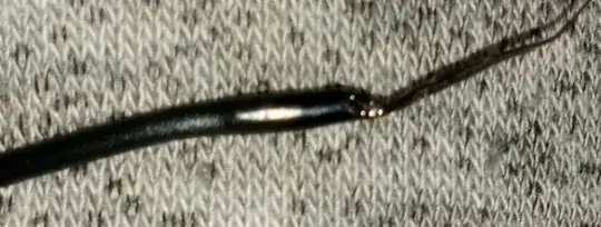

I read that there could also be another thing causing case 1 and that is over-extrusion. To verify this I did the 100 mm extrusion test where I marked 0 mm and 100 mm and extruded 100 mm manually in steps of 0.1 mm. It took a while but eventually in the end I determined that it is under-extruding at 95 mm actual filament extruded which means there is less filament being pushed which should actually be working against the jam. I pulled the filament out after the test to see what it looks like and this was it:
Photo of filament with significantly different sized diameter
Nevertheless, I adjusted my E-steps from 93 to 99 and repeated the 100 mm test again which this time was about 1 mm off (99 mm actual filament extruded) but I guess my markings could be off too so it should be good enough. I again checked the filament and it still had an expansion on the end.

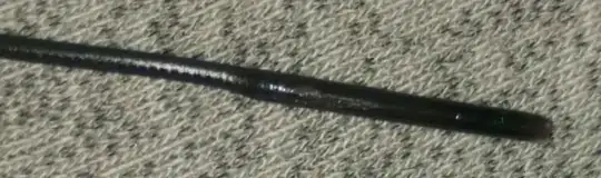

Just to confirm this was the problem I took quite a large home fan and directed it such that the stream is hitting the radiator from about 5 cm (this is while the hot end fan is not mounted with the screws but hanging on the side, which was also blowing at the radiator). I waited a couple of minutes and measured the temperatures again which this time showed 35 °C on the top and 50 °C on the bottom. That was as low as I could get it and the house fan was pretty strong. I extruded another 100 mm manually and this is what the filament looked like afterward:
Photo of filament with a blob of filament a the end after being pulled from the hotend
It still had a blob on the end and I'm pretty confident given more time it would clog up again.

This is classic heat creep. What's happening is that you're getting softened material up inside the 2.0-mm-inner-diameter PTFE tube, and then, because it's soft, some of the extruding force causes it to deform and expand outward rather than go through the nozzle, because that's the path of lesser resistance.
So, where is the heat creep coming from? In my experience it's not common on an Ender 3, but there are at least 3 fairly likely possibilities:
  1. Ambient temperature in your printing space is sufficiently high (perhaps driven by bed temperature if the space is somewhat enclosed) to make the hotend cooling fan insufficient.
  2. Hotend cooling fan is damaged or wearing out and running at severely decreased flow.
  3. Your retraction length is way too long, and on each retraction, you're pulling up molten, or at least softened, material into the PTFE tube, then squeezing it as soon as you unretract.
It's possible to be a combination of these things. For example if your retraction length is too long, things might go okay until the air warms up from printing, then eventually get to a point where the added ambient warmth keeps the material soft just long enough for it to jam.
Some things that could help:
  • Make sure you printing space is well-ventilated and air conditioned if ambient temperature is warm (I'd say over 26°C is bad for printing PLA). If you can't do that, run a desk fan pointed at the printer.
  • Try lowering your retraction length, especially if it's over 6 mm now, but be sure to perform retraction tests (stringing tests) to make sure it's still sufficient.
  • Use faster travel speed/acceleration and faster retract/unretract so that you're not giving time for heat to transfer from the retracted filament into the cold side during travel.
Given the temperatures you measured, though, I wouldn't be surprised though if you have a bad fan that needs replacement.
