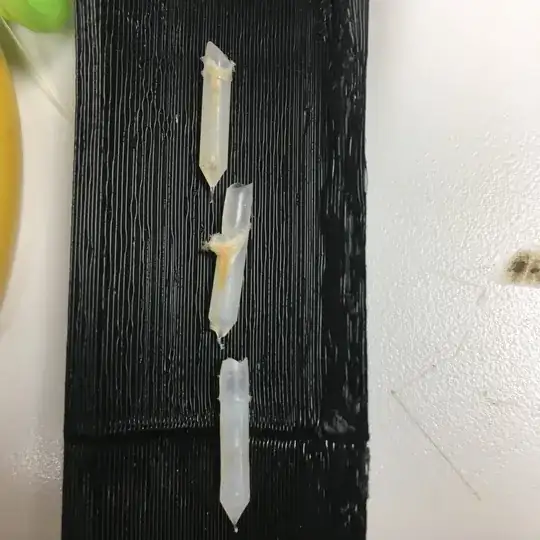

After thinking the problem was the extruder, taking it apart, cleaning, trying a few different tensions on the hobbed gears, my attention shifted to the hotend. I did some cold pulls with nylon, and each time the nylon would come out with this frayed ring of plastic about 15 mm above the cone from the nozzle tip. It’s like it was a separate piece of plastic from the filament, but it seems like it constricts the path. This ring is about the depth where the heat break screws into the heat block. I supposed it could have started higher in the cool end and gotten pushed down? I suspect the grooves pressed into the filament by the Bondtech might be prone to hang up on this plastic gunk ring.

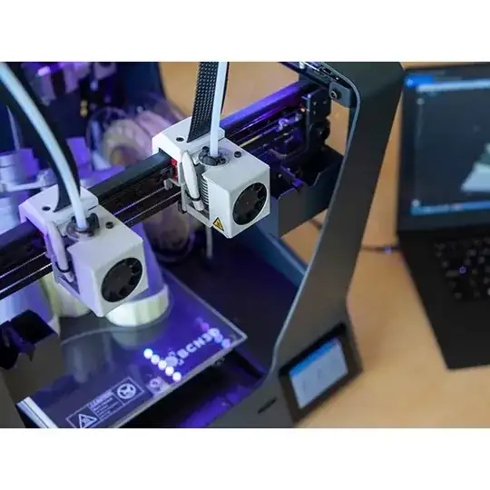

Their hotend design is all metal, similar to the V6 (and apparently manufactured custom for them by E3D). Different, taller nozzle. It has a 30 mm fan blowing on the fins. There is no shroud on the fan, like the blue thing on the V6. The heat block is halfway up into the enclosed part with the cool end and fan. The fan blows on the heat break and the block.
One of my cold pulls shows a little bulge, right about where I think the brass nozzle butts into the heat break steel piece. I’m wondering if there is a gap there that plastic melts into? They do an inconvenient thing where they sell the hotend as a whole piece for $125, and apparently you can’t unscrew the nozzle like a V6, people report the threads get ripped out of the heat block. All to say, it isn’t advised to completely disassemble the hotend.

Is this what your hotends look like? enter image description here
They look like Bowden tube extruders. Your images are consistent with heat creek for Bowden tub extruders. Can you print with the enclosure open to see if the problem is at least less?
