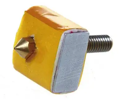

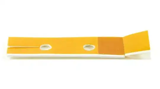

I find pre-cut ceramic tape + kapton tape "blankets" to be easy and effective. E3Dv6 and Replicator 1/2 style hot blocks should be compatible. Or you can cut your own using a sharp hobby knife.
enter image description here http://www.fargo3dprinting.com/products/makerbot-replicator-2-ceramic-insulation-tape/
The main downside is that they don't insulate two sides of the hot block. But covering the top and bottom provides much of the practical benefit, and you can always add a few more wraps of Kapton tape to cover up the rest of the surfaces.

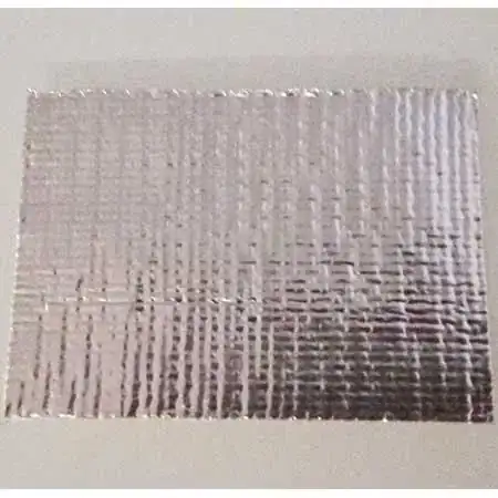

Another good option that has recently started to become popular is fiberglass heat shield tape. It has a silicone adhesive, woven fiberglass mat, and shiny aluminum surface. (The reflective surface reduces heat radiation.) It's often used in automotive applications around mufflers and the like. You can cut it up into little rectangles for each side of the hot block, or wrap the block similar to Kapton.
enter image description here https://shop.raffle.ch/shop/insulation_material/
Main issue is quality -- not all brands have adhesive that will hold up to high temp printing. It may smell when initially "burned in" due to the adhesive cooking a bit. I also find that you need a couple layers to get as much insulation as the ceramic+kapton blanket when there's a lot of airflow around the hot block.

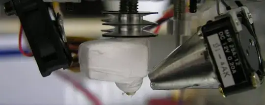

I ask myself why people hassle with kapton tape when it is so easy to use teflon sealing tape to isulate the hotend. This tape is slightly foamed to allow better sealing when used for sealing "tube threads". It can be purchased anywhere for very little money and can stand up to 260° Celsius constantly and 300 ° for a short time (according to its data sheet) This shoud be sufficient for most applications. Water installation PTFE tape is very easy to apply because its soft and can be stretched to the right form. And it sticks for its own without extra glue. No hassle like with the stiff kapton tape. And the isolation is much better because of the air bubbles inside the tape. I did that on my extruder and it works perfectly. My extruder heats now up about 20% faster. I applied this tape in installed position within 5 minutes - easy ! Teflon tape isolated extruder

    Welcome to the forum! I like your idea to use plumbers tape, and I'm sure I will try it. This answer doesn't directly address the OP's interest in comparisons, but it is on-topic. Could you improve the answer by comparing it with your experience using other insulating methods? – cmm Nov 13 '17 at 03:09
  • Sounds like a great idea, but is there any issue with the toxicity of the fumes (even if no odor)? Just curious. – Questor Apr 26 '18 at 19:57
    @Questor , this is indeed an issue with PTFE tape: https://en.wikipedia.org/wiki/Polytetrafluoroethylene#Safety It starts releasing some non-great stuff at 200C, and increases with temperature. In the study cited by Wikipedia, the amount isn't worrisome until 250C, but this isn't a frying pan...we run these things at temperature in enclosed spaces for hours/days at a time. So I avoid PTFE in contact with the heater block, but it's in an abundance of caution. – Christopher McGowan Nov 28 '18 at 07:22

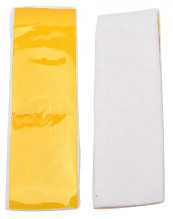

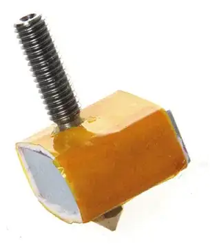

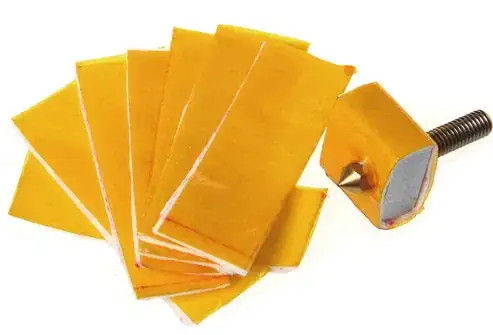

After having seen this answer to this question, How can I insulate my thermistor?, I ordered these, from eBay, 5PCS 3mm Thick 3D Printer Heating Block Cotton Hotend Nozzle Heat Insulation EW, for around £0.40
Blurb from the item's description
  • Thickness: 3mm
  • Dimension : 75mm*21*3mm +/-0.2mm
  • The heat insulation cotton is used for 3D printer nozzle keeping warm;
  • The heating insulation cotton is made from heat-resistant ceramic fiber;
  • The product sizes can be customized according to customer needs;
  • The benefit for keeping the key parts of the 3D printer heating aluminum block warm;
  • Is making the internal temperature flat, saving power,and energy;
  • This High temperature resistant cotton can work for a long time in high temperature of 900 degree.
Other images:
enter image description hereenter image description hereenter image description here
Granted, these look suspiciously like the strips in Ryan's answer, but use cotton, en lieu of ceramic tape.
