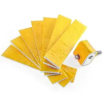

at 1:37, you'll see that the hot end is wrapped in cotton and Kapton tape. Like the stuff that is cheap and easy to buy:
and that the casing cover is removable, so you should be able to open it to insert new cotton. Why worry about voiding warranty? You can gain a working printer for a few bucks or bite the bullet and buy a new Makerbot Smart Extruder. I guess if you had warranty you could already have it replaced by now.
