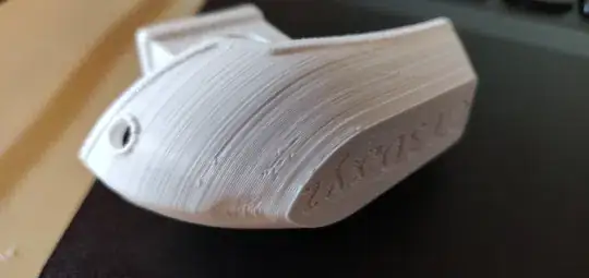

First of all, I'm quite new to 3D printing. After printing some temperature towers, stringing and bridging tests, I wanted to print the Bechys to see everything working together. I'm getting some strange "bumps" in the outer walls. It looks like for 2-3 layers, the filament gets lifted up.
infill before walls set
infill before walls unset
I first thought, the infill is printed too far in the outer shell, so I unchecked "Infill Before Walls" in Cura. Surprisingly the outcome did not change and the "bumps" where in the exact same spots as before.

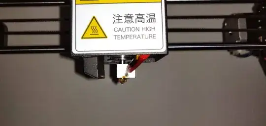

I am aware of a part cooling problem, but my stock cooler already sits at 100 %. I don't think, the extruder temperature is too hot, with it being only 200 °C. As you can see, the printer only has a one sided cooling solution with a very small fan conduct.

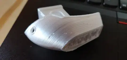

Update: I started the print again with aligned seams. Now you can clearly see the artifact. At the point of the seam the print is warped inwards and upwards.
aligned seams
I did some more prints and tried to increase retraction distance up to 10 mm and retraction speed up to 60 mm/s, but I also did not manage to improve the print. I also tried to enable the "retract at layer change" option and to disable "Z Hop When Retracted" but without success.

    Hi welcome to 3DPrinting.SE! What can be seen on the bottom photo is that your nozzle is a little too far from the bed, and you aren't using enough part cooling (see the overhanging bow). – 0scar Jun 18 '20 at 22:00
  • @0scar I am aware of the part cooling but it already sits at a 100 %. I think I will do an upgrade shortly. I have already done a temperature tower, bridging and stringing tests. The benchy was just to see everything together. How did you determine, the bed being to far away from the nozzle? – mrei Jun 19 '20 at 07:11
    If the fan is already at 100 %, then you print too hot or the cooling fan doesn't provide enough flow, many print fan ducts constrict airflow, we cannot see what you are using. Your first layer doesn't look that well, there are many channels, but it is hard to tell from the photo. Sometimes 200 °C is just too hot, most PLA can be printed from 185 °C. The last photo looks as if the nozzle has overpressure at the end of the outer wall or oozed out filament at the start of the outer wall.This could be a retraction issue. – 0scar Jun 19 '20 at 08:01

  • @mrei The heater block should probably have some thermal insulation on it. See if you can find a silicone insulator made to fit it, otherwise: [Efficient and easy way to thermally insulate the heat block of the hotend?](https://3dprinting.stackexchange.com/q/1247/11255) – Andrew Morton Sep 03 '20 at 10:26
  • I agree with Andrew, that heater block gets cooled by the part cooling fan, which has an awkward position. Otherwise, I see that all the errors are at the start of the lines, and there is some underextrusion around it, hinting that you have to tweak your retraction distance. – Trish Sep 03 '20 at 13:16

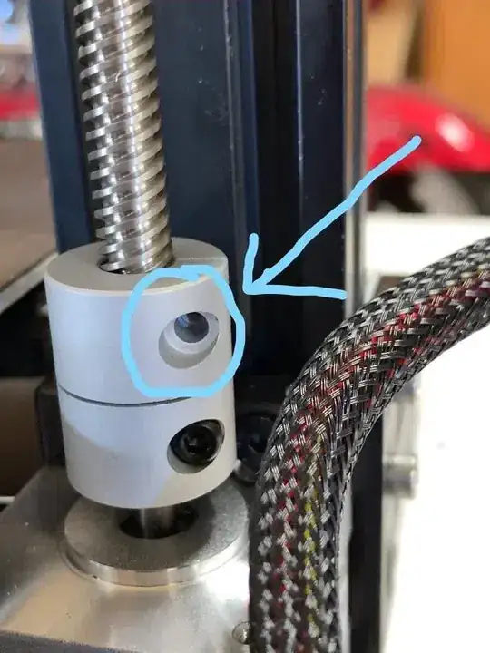

The fact that the bumps were in the same spots on multiple occasions points to z-axis problems. Turn your printer off and manually turn the z-axis all the way from bottom to top. If there are any tight spots, there is some z-axis binding. If there are no tight spots, skip to the last paragraph.
Try taking off the z-axis by removing the set screws (pictured below). Remember which side was pointing up for a later step.
Once you do that, clean the screw thoroughly with a brush, cloth, solution, or a combination of those. Put the screw back in the opposite way this time.
If you get no bumps, then it was indeed the z-axis
If the bumps are still there, try lowering your temperature some more(200 is still a little high compared to what I do for PLA), and calibrate your e-steps if you haven't already.
