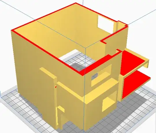

I'm trying to print an architectural model of a house with 2 floors and a room on the roof. It was designed in SketchUp by a friend. I removed inner walls and floors to print it upside down to get just the outer look of that building. All is good in SketchUp and in Meshlab (converted .skp to .3ds) and even after exporting it to .stl format. But when I slice it and select preview, it is adding a floor on its own. Please take a look at the attached screenshots to get a better idea of what I am referring to. Any idea what's causing this and how it can be solved?
Prepare.png shows model before slicing
Preview.png shows model after slicing
(Using Ultimaker Cura 4.1.0 for slicing at 0.2 mm layer height)

  • I don't think your STL file is okay, it appears that you removed the floors, but there might be some problems with the normals of the faces. Maybe you can fix the file through NetFabb. – 0scar Sep 14 '19 at 12:59

  • It looks like supports except I don't see anything that 'floor' would be supporting. I suspect it's more likely that the STL file is invalid like @0scar said. – R.. GitHub STOP HELPING ICE Sep 14 '19 at 22:22
    you can, in the preview, disable viewing the normal material and just display supports. Could you share a picture of that, so we get a better clue what type of print cura generates for you? – Trish Sep 15 '19 at 09:24
    When I printed a similar house model designed in SketchUp, the generated .stl was of horrible quality. Windows 10's build in "3D Builder" has a very powerful .stl repair tool built in, which got rid of the defects. – towe Sep 16 '19 at 08:02
SketchUp has a problem with generating the normals of an STL in the right way. As you see in the slicer, the model claims, that the "tops" are overhangs, which means that the whole model is "inside out" with the normals.
