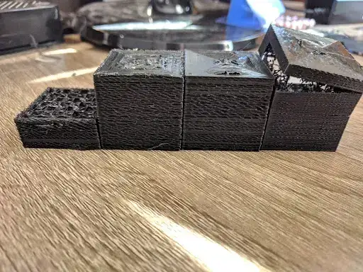

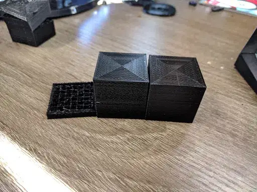

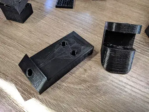

Here are some pictures of the prints I've been getting: These were made in Ultimaker Cura with different small changes to the profile made
Ultimaker Cura Settings Under Extrusion
These were made in slic3r with a flow rate adjusted up to 130% Slic3r Under Extrusion
These were prints I made before I lost all my settings in Ultimaker Cura. Good Prints

  • Hi Tinkerman255 and welcome to the 3D Printing.SE! I don't want to rude, but your "good prints" are not that well either. Are you sure it isn't an issue that progressed over time or over the crash? Please do check the filament diameter setting, it fooled me countless times when I changed to a newer Ultimaker Cura version and use both 2.85 mm as 1.75 mm filament intermittently. – 0scar Mar 11 '19 at 07:34
  • I agree with you that the print quality before the crash wasn't the greatest. However, it was very consistent and strong, so I had no complaints. It printed with that quality since the time I got it, so I'm confident it isn't an issue with the hardware. As for the filament diameter, I made sure it's all set correctly, and that hasn't helped either – Tinkerman255 Mar 11 '19 at 16:21
It is not too rare to create a new machine in Ultimaker Cura to be set to 2.85 mm as this is the default. Also some bugs in the past did reset or assume this diameter unless you manually set it, and unless we know your exact version we can't confirm it is really this.
Underextrusion why?
The 0.55 mm more radius result in an underextrusion due to the pressed through volume, and since $V=A\times l$, we need to see the area to see how severe the underextrusion is for one given extruded length. $A_{1.75}=2.405\text{ mm²}$ and $A_{2.85}=6.379\text{ mm²}$ are rather obvious, so $\frac {\text{real extrusion diameter}} {\text{calculated extrusion diameter}}=\frac{A_{1.75}}{A_{2.85}}=37.7\ \%$, so only about 40 % of the needed filament is pressed through the nozzle as the slicer thinks it is almost twice the diameter. This matches well with the 130% still being very spotty, as that'd need a much higher factor to compensate for the underextrusion. A compensating extrusion multiplier would be $\frac 1 {0.377}=265.25\ \%$.
Fixing
To fix this, check under filament and set it to 1.75 mm so you force the correct diameter. Remember that filament diameter is not saved in the printer profile but in the material database.
You might need to restart Ultimaker Cura to activate these new settings.
