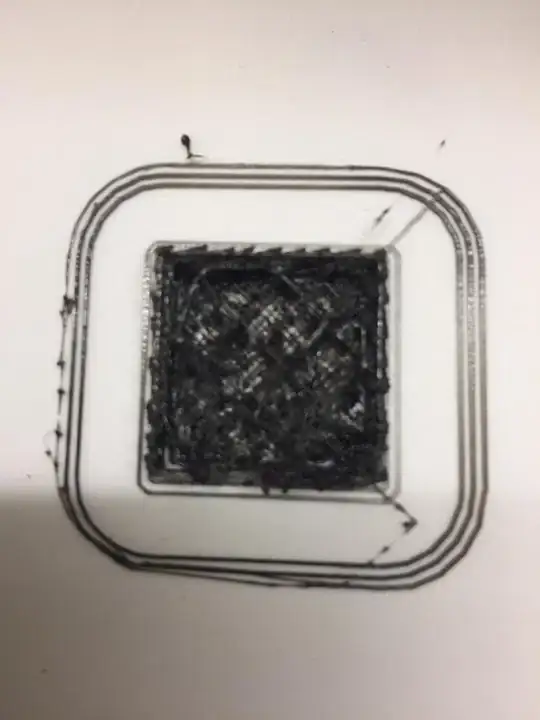

I did calibrate the extruder to extrude exactly 50/100 mm and it is fine. I have replaced the old (prehistorical) extruder that was giving me the problem with a new one. The issue does not go away. It is severely under extruded. The nozzle is a 0.4 mm, if I extrude manually the extrusion is nice and clean but when printing its a mess. I have the following setting in Slic3:
  • Layer height: 0,16
  • First layer height: 0,16
  • Filament diameter: 2,94
  • Extruder temperature: 184°C
  • Extrusion multiplier: 1
  • Fill density: 15%
In Marlin I have the following setting for the extruder:
  • Steps per unit: 1450 (I use micro steps)
  • Default acceleration: 3000
  • Default retract acceleration: 3000
  • Default Ejerk: 5
How can I solve this problem?

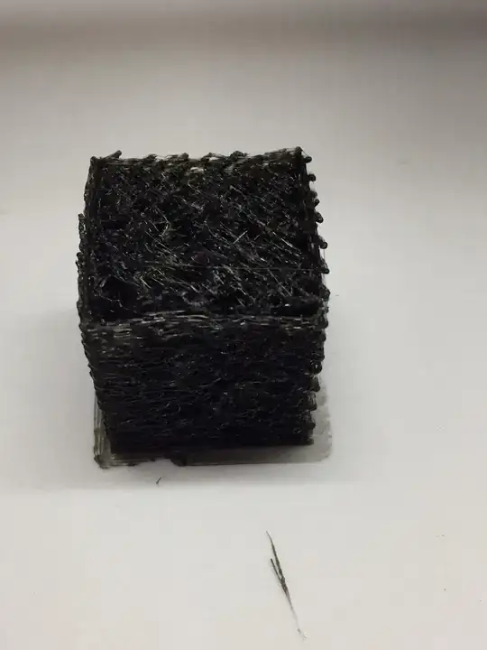

This is a 20 mm cube I stopped after 15 layers!
Here is another 20 mm cube, the dimensions are perfect but is absolutely a mess. enter image description here

Assuming your filament dimension settings are correct and your extruder is correctly calibrated...
Your extruder temperature may be too low. While 184C can be hot enough, it is very near the bottom of the range for PLA and it appears your filament isn't melting quickly enough to keep up with your other settings. Your extruder may even be running slightly cooler than you think so your 184C setting may actually be printing at 180C or less.
To solve this:
  • Raise your extruder temperature. I suggest raising your print temperature to 220 degrees and then gradually lower it until other aspects of your print quality are acceptable (bridging, oozing, etc).
  • Slow down your print. Slowing down reduces the volume of melted plastic your extruder has to deliver in a given amount of time. This allows more time for the plastic to melt and allows you to use a lower print temperature
Your filament feed mechanism may be slipping. Even if you have adequate temperature and perfectly calibrated firmware and print settings, if your filament feed mechanism (the thing that pushes filament into your extruder) is slipping, you will have under-extruded parts.
To solve this:
  • Make sure you have adequate tension on your filament feed mechanism. If your feed mechanism is too loose, filament may slip and cause under extrusion. The part to check is the part the pushes the filament into the rotating hobbed bolt or friction wheel...make sure it applies adequate pressure. "Adequate pressure" or "adequate tension" will vary depending you your printer's design, but it should be enough to provide a firm grip on the filament.
  • Verify your feed mechanism is clean. A hobbed bolt or similar filament drive mechanism that has become clogged or otherwise contaminated may cause filament to slip and under-extrude.
  • Ensure the end of your filament is not damaged from slipping. Once your filament has slipped, it may be damaged with a worn spot, a bulge, or some other defect that can prevent proper feeding even after you fix the root cause of your problem. So, as tbm0115 pointed out, be sure to clip off the damaged end to make sure you have good filament feeding into your extruder.
I hope this helps!
Chris Thompson
  • 1,051
  • Thanks for the good hints. I will try. I also start suspecting the robbed bolt in the extruder which is quite old. – FeliceM Oct 19 '16 at 14:23
    As a result of under extrusion, the end of the filament may also need to be snipped if the drive gear has dug into the filament. – tbm0115 Oct 19 '16 at 14:38
  • Good point tbm0115. And check the hobbed bolt and clean off any filament that has become ground into the grooves. – Chris Thompson Oct 19 '16 at 15:18
  • Updated answer to include the slipping filament issue and solutions...inspired by tbm0115. Important. – Chris Thompson Oct 20 '16 at 04:27
  • Thanks for the useful hints. I replaced the hobbed bolt which was the main cause of the issue and the problem is now manageable from settings in the slicer. I was lost because I resuscitate a hold printer replacing motherboard, extruder, drivers and firmware. Basically starting from scratch because I was unable to upgrade the firmware on the old Sanguinololu. Even worst I did not have the firmware settings of the old one. So was a bit difficult to understand from where the issues was generated. So far so good.....it was simply the HOBBED BOLT! Thanks – FeliceM Oct 21 '16 at 15:36
    Glad that solved it for you! Another possibility (for future readers), is any setscrew(s) connecting your hobbed bolt, gear, or whatever to the extruder motor shaft. Mine loosened up once and it was (of course) the last thing I thought to check... :( – TextGeek Oct 28 '16 at 17:07
