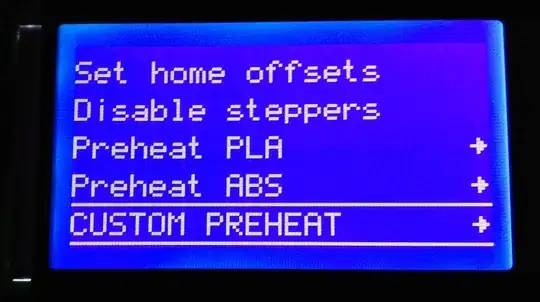

As a quick demonstration, I've added a CUSTOM PREHEAT item by copying the lcd_preheat_m2_menu function in ultralcd.cpp and renamed this lcd_preheat_m3_menu (a full functional item needs changes within the lcd_preheat_m3_menu as it now uses the constants from the ABS preheat option).
You then add the item to the menu by changing this part of the code:

After compiling and uploading to the printer board, enter the Prepare menu and scroll down to see:
LCD showing custom preheat option
