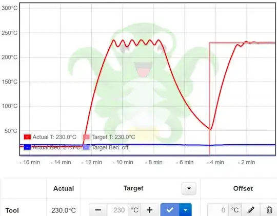

Since I have lots of PETG, I ran tuning to 230 °C (average temp for my filaments). What is it good for, in terms of temperature ranges?
For the same printer configuration, and just different filaments, will I need to run it again and again? Let's assume that I'll be printing between 200 °C and 240 °C.
marlin pid via octoprint
