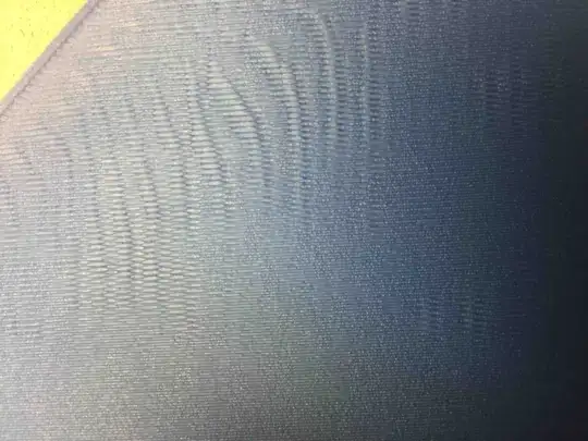

I'm having issues with ripples on the first layer of big flat prints. The initial corner of a big flat print is fine, but then ripples begin to form as shown in the screenshot.
I'm just a newbie, so I was thinking they might have something to do with heat or contraction or something. Normally, I use the default and print with no turbofan on the first layer. When I tried adding fan 20% or 50%, nothing much changed (slight differences in the ripple pattern and area, but that pattern varies anyway).
I also wonder if one strip gets bent, then maybe the rest just follow the bends. As far as I know, my heating plate is working fine, has no serious hot spots, and I'm using a high-quality PLA+ filament. I also tried adjusting the print temperature from 205-220 (the range on the box is 205-230). Nothing seemed to help. I am running a default first layer thickness of 0.3 mm because that is supposed to help adhesion (and adhesion is fine).
The ripples look worse than they feel. They feel fairly flat, only slightly rippled, even though they look terrible! (And I don't know what that weird row with blobs is in the top left of the picture. That only happened once; almost like junk was in the nozzle or the feed gears slipped or something).
I'm running a Qidi Xpro machine, Sunlu PLA+ (wonderful) filaments, bed 50 C, print temp 205-215, print speed 30-40 mm/s on the first layer, and first layer thickness 0.3 mm (normal layer thickness is 0.2 mm). This machine has a direct drive with gears immediately above the nozzle.
Does anyone know why this rippling effect occurs, and what I might to do to correct it? Thanks

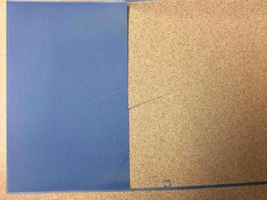

Here is a picture of the bottom of the piece. A careful examination shows an oscillation in the squished filament segments on a filament thread. Almost like the extruder was oscillating vertically in the z-axis at that frequency, or perhaps the filament squishyness was oscillating at that frequency. Looks almost like a weave pattern, since the squished parts alternate position on alternating lines.
It's worth saying again that the piece feels pretty smooth on both the top and bottom sides, even though it looks awful. I don't know what to make of that.
Ripples on the top side towards the middle of the plate

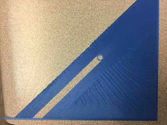

The following image shows the problem. I was running with a default 0.3 mm first layer (the tooltip setting says a slightly thicker layer helps with adhesion). The build plate was correctly leveled with "midrange" friction on the leveling card at the leveling points.
Problem cause: The midrange leveling height put the nozzle too close to the plate and caused rippling. The first layer thickness was set to 0.3 mm and the thickness of the leveling card was 0.25 mm.
The following image illustrates the problem (and one of the solutions). The bottom right of the image shows rippling. Not knowing what else to do with the "too close" or "too far" or "unlevel" tips in the comments, I just manually lowered the build plate knobs 1/4 turn while the print was in progress. The print began in the lower right. You can see the smooth area where I manually lowered the build plate. Then, to be sure, I raised the plate by restoring the 1/4 turn on the knobs. The rippling returned.
Ripples disappear when build plate is lowered 1/4 turn on the knobs
To further explore the 0-90 degree suggestion provided by profesor79, I changed the slicer degree settings to 0-90 degrees and set the first layer thickness to 0.2 mm, which was equivalent to lowering the build plate knobs by 1/4 turn. I kept the same "midrange" friction settings when leveling. The result was a first-layer print with no rippling.
No ripples with 0-90 degree settings and new build plate distance
