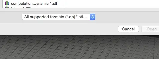

I gave the STL file to the branch manager who tried to open it in the Makerbot software so that it could be sent to the printer. But, it gave him a message about the file not being recognized.

Makerbot will accept obj files also. Is there an error while importing the obj file? Also you can see errors of your imported file in your makerbot It will be marked in black.
