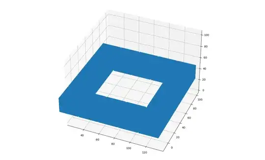

We've been doing some work automatically generating STL files using Python. We've made a ring of cubes like so:
Python generated ring of cubes

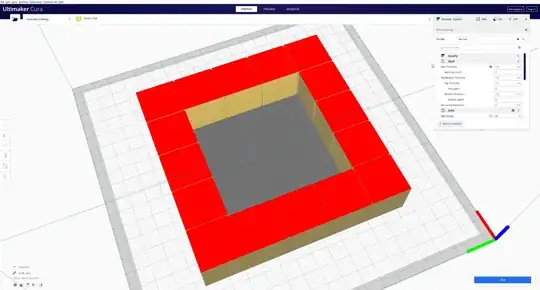

Importing it into Cura still makes it look valid, with a hole in the center:
Ring of cubes in Cura

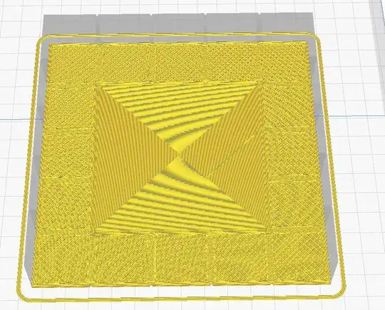

However, post slicing it comes up with saying it will take 14 hours to print! A ludicrous time. Looking at the preview, it seems to be adding supports to the entire inside of the structure:
Slicing preview

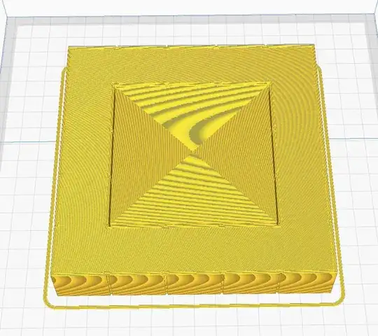

And also a top / bottom layer:
Slicing preview - top
Slicing preview - bottom

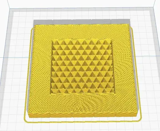

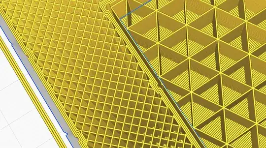

Why is this? You can tell it's adding supports to the center and is not filled in due to the differing structure midway through the block:
Close up of support structures midway

    I'm new to this forum, but am quite experienced in generating 3d models. Can you share the STL that is causing the problem? I suspect you have concave surfaces that aren't triangulating as expected. Have you tried opening your STL in Blender and running the 3D print tests that software provides? – Ron Jensen Jun 30 '21 at 22:11
    Any suggestions for a site I can upload the STL file to? I'm happy to, it's just a square so it's not private. @RonJensen – Alexander Craggs Jul 05 '21 at 11:30
  • Found out you can upload it to GitHub, so here's the code that generates it and the STL file. The GitHub rendering of the STL file seems wrong. Blender, Cura and MatPlotLib all seem to display it accurately. https://gist.github.com/popey456963/470d995032d321b6e49100c51d65f249 – Alexander Craggs Jul 05 '21 at 11:34
  • Your normals are flipped randomly. When you generate the vertices of the triangles you need to keep the winding order consistent. This is important to Cura so it knows what the "inside" and "outside" of the model is. – Ron Jensen Jul 05 '21 at 23:48

The surfaces are clearly ill defined - it shows the top surface as a bottom one (those are marked red), and so the normals of that surface are pointing to the wrong direction.
