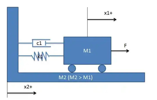

To add to that answer and get on topic of your question and your possible solutions I'd like to say that neither of the solutions you provide is correct. What do we know? We know that ghosting depends on the mass of the printer head being accelerated and decelerated. This causes overshoots that are damped out by the construction causing the ripples or ringing effects that die out after a few mm of printing.
If the head is considered to have a mass M1 and the printer mass M2 (where M2 is larger than M1), the following simplified figure can be drawn:
Note that the head is without friction (which is not the actual case), when the head is subjected to a force, or suddenly a force acting on mass M1 disappears, the mass M1 wants to travel further; the spring and the damper then come into play causing a dynamic displacement of x1.
If you assume the printer to be bolted to the ground, M2 becomes the mass of the earth (M2 >>> M1) and solely the x1 displacement is taken into account. However, if you hang it freely (M2 > M1) or use rubber damping between the printer and you get a complex vibrating system where mass M1 influences the displacement of mass M2. E.g. M2 is now connected to the earth (or not if freely suspended) with its own damper and spring (or free). If x2 and x1 are in phase the effect may be even stronger than if x2 and x1 are out of phase. This all depends on the values of the spring and damper values and the involved mass weights. Although clamping down seems the best way to go forward, putting the printer on rubber matting or feet may be more comfortable as it reduces the vibrations.
This demonstrates that the displacement of M1 will always exist until you either fix the mass of the head (M1) or the force acting on mass M1 (lowering speed and jerk).

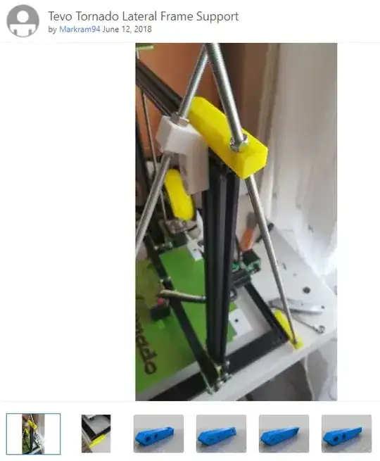

The forces and vibrations inside printer will propagate over every single part connected. Having that in mind, making rigid external frame is just a part of the solution.
Please consider some extra points:
  1. filament spool on the top bar adds vibration to the frame (get a rubber pad to separate hook from the frame - but I will remove it from the printer)
  2. steper motors are mechanically noisy as well - get a stepper damper (as a piece of thin rubber between the motor and bracket)
  3. moving speed and acceleration also adds a pressure to the construction, so high acceleration and braking need to be reduced (when you put hand on the frame you will fill all those movements (close your eyes))
  4. stepper drivers also have an impact on the quality side (circled model skin)
  5. you also could add an extra tensioners from top of the frame to the base.
Fixing it to the floor will be a benefit and considering points above will also improve printing quality.
an alternative lateral frame:
