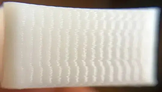

Ghosting is an artefact in the print due to the vibrations in the printer that are induced by rapid changes of direction. It is important not to confuse them with inherent vibrations in the printer due for example to the belts being loose or the bearings not being in perfect order.
The good news is that it is relatively easy to tell them apart: ghosting (also known as "ringing" or "ripples" or "waves" or a number of other names...) is always downstream of a change of direction, and fades rapidly.
ghosting

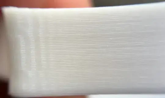

Inherent vibrations - on the other hand - tend to be consistently present when printing along a given direction, and do not fade.
inherent vibrations
