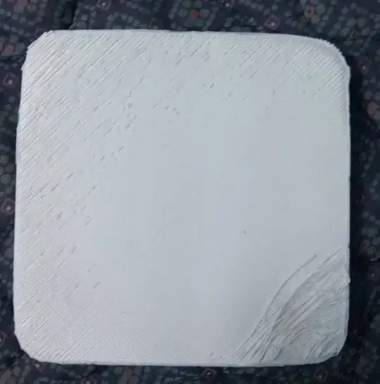

Edit2: Attached image is the bottom surface of the 100 mm cube. You might notice slight charring on the bottom right corner. The masking sheet I pasted on the print bed was charred underneath. Also, it's evident that the bottom surface is not as compact at the corners as it is in the center.
100mm cube bottom surface
What could be the possible reasons for that?
