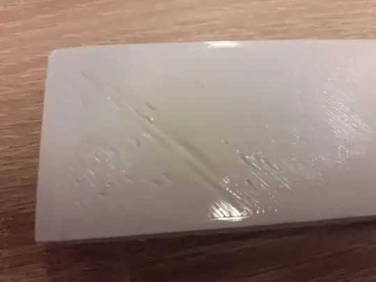

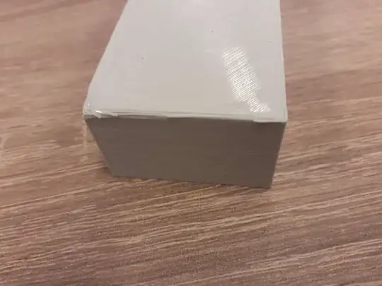

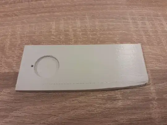

Photo 1 of a printed model #1 with printing errors on bottom layer
Photo 2 of a printed model #1 with printing errors on bottom layer
Photo 3 of a printed model #1 with printing errors on bottom layer

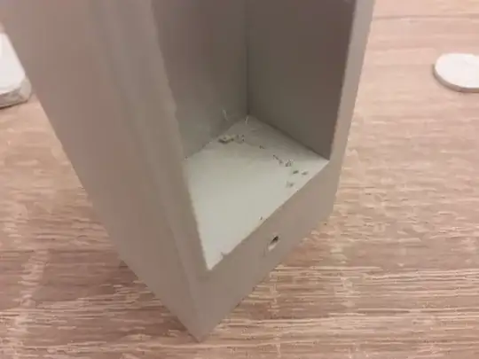

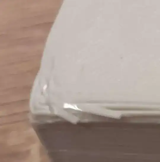

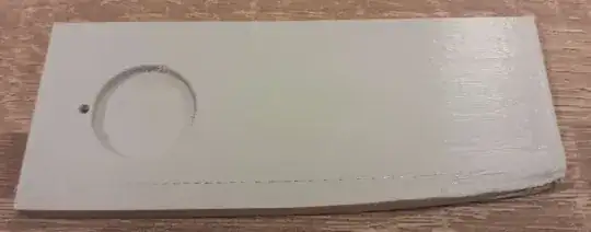

Photo 1 of a printed model #2 with printing errors
Photo 2 of a printed model #2 with printing errors
As you might be able to tell, this one has some more severe problems, like the prolapse on one of the corners of the lid and some threads that just seem to be broken off here and there.

There are several issue at hand here, first you have an adhesion problem.
This print shows that the print (as it is printed upright) has come loose during printing and lifted up. Such a print should have been printed as it is now laying on your table. You will then also get far better quality of printed holes. So, second is print orientation on the build plate.
This shows another example of adhesion problems, but it also shows that you initial distance between the nozzle and the bed is slightly too large. The paper method usually works fine, but you can use feeler gauges. Alternatively use a specific 3D print adhesion spray (3DLAC, Magigoo, DimaFix) or alternatively some hairsprays or glue sticks.

Fourth, this shows that there was no filament printed, it could be that the spool had extra resistance or the filament was entangled. Check your filament spool.
Fifth, this shows that you have a retraction problem, the filament pressure is still too large when the head moves to the next coordinates, it then oozes until the pressure has been released. Changing retraction speed or distance may help.

That pin will never work - 3D printing has layers and items are always weak along the layers. So that part is a poor candidate for 3D printing.
Instead, buy a large assortment box of M3 nuts and bolts. These work much better than thin printed parts.
Also, that large lid should be printed laying flat on its back. Even the action of the bed moving around could be creating enough breeze to cool that part quickly and cause shrinkage.
