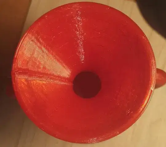

I printed this Curvy vase from Thingiverse and it came out pretty well on my Chiron.
Curvy vase print
However, I am not happy with the Z-seam that is very large. When I look at other people's problems with this, they often seem to have too little filament at the seam, but I have too much. What setting should I change to make it less visible?

  • You might want to look into your retraction settings. Also look into the preview in Cura what happens at the seem, e.g. look for retraction and moves prior to the seem printing start. Note that overpressure in the nozzle can cause bulging out of filament at printing the end (up to) the seam. – 0scar Mar 01 '21 at 22:32
  • Overpressure seems a reasonable explanation to me. I retract 6 mm at 40 mm/s and prime the same length at 30 mm/s. Slower priming because I read somewhere that too fast priming cause some problem, but I don't remember what. My Bowden tube is as short as possible and new. It moves ~1 mm when doing these retractions. And then there is a Z-hop happening. I guess the best thing would be if the nozzle left the "crime-scene" as soon as possible. Would it be better to skip retraction or Z-hop to save time? – dotswe Mar 01 '21 at 23:40
    For such a short Bowden tube, 6 mm might be a lot. Z-hop can also be disabled. Furthermore, PLA can be safely printed at higher speeds than e.g. PETG; you haven't mentioned the print speed. – 0scar Mar 02 '21 at 09:25
  • Just a guess, but I would check to make sure retract on layer change isn't set, to make sure you don't have unnecessary retractions. – Perry Webb Mar 02 '21 at 20:05
  • The Bowden tube is as short as possible, but the Chiron printer is large, so the length is ~500mm. Retract on layer change is not set. Print speed was 55 mm/s. The place where the bulge is, is not the first nor last thing that is printer on each layer. I will test different retractions and disabling Z-hop in a day or max 2. – dotswe Mar 03 '21 at 04:07

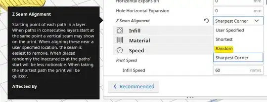

There is a Cura option to choose a random seam alignment in the shell menu:
Z-seam alignment
This setting allows you to choose where each new layer in the Z direction starts and affects where the seam of the model will be. This is useful for models with consecutive equal layers as the seam can be visible. By changing the Z-seam alignment you can decrease the visibility of the seam. The options available are:
  • User-specified: Set a coordinate for the X and Y direction of the Z-seam. This coordinate is absolute by default. Example: X 100, Y 200 will move the seam to the center back of the model.
  • Shortest: The next layer starts at the endpoint of the previous layer. This is the fastest way of printing, but also creates the most visible seam.
  • Random: The next layer starts at a random point of the previous layer, which eliminates the chance of a seam. Print time will increase due to the necessary travel moves.
  • Sharpest corner: This puts the seam in the sharpest inward or outward corner of the model, when available. This is the best method to completely hide the seam.

A bulging seam is caused by a mix of factors, especially:
  1. Material oozing while dwelling too long at the point of layer change (including the time spent in the Z move). This can be mitigated by ramping up the max Z speed and acceleration and/or enabling retract at layer change with a very fast retract and unretract speed (without doing it very fast, the time spent retracting has the same effect as the time spent on Z move).
  2. Excess extrusion due to pressure remaining at the nozzle when decelerating. This can be mitigated by enabling Linear Advance and tuning the K factor for your printer's bowden tube and material properties. A value around 0.5 is probably needed for PLA on your printer. Increasing your acceleration limit to reduce the time spent accelerating/decelerating can also go a long way to mitigate this.
  • Ozing is the problem, as 0scar also has written. – dotswe Mar 07 '21 at 06:37
  • Regarding time spent on Z move; Cura has a normally hidden setting called "Z Hop Speed" that was set at 10 mm/s. I raised it to 30, and hopefully it will do good. – dotswe Mar 09 '21 at 22:26
  • @dotswe: This isn't a Z-hop. Z-hop is an optional temporary Z move done together with retraction before travel. It makes oozing/stringing worse but mitigates colliding with the previous layer when you have warping or overextrusion problems. The relevant thing here is just the normal Z movement speed. – R.. GitHub STOP HELPING ICE Mar 10 '21 at 01:22
