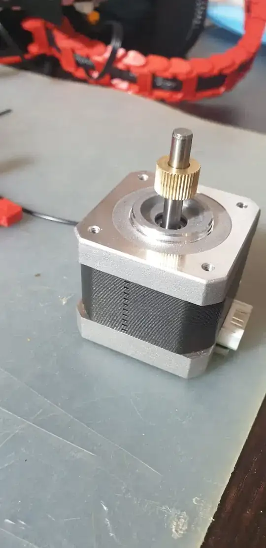

The Problem, as you might expected already, is with the installation of the dual gear extruder. I have watched a dozen of YouTube videos, and all of them have something I don't – a screw in the stock gold gear on the extruder motor.
How can I install the Aluminum Dual Gear Pulley Dual Drive Extruder Kit if I take the gear out? Should I try remove it with force? Please if someone has come across the same situation, that there isn’t a screw In the stock gear on the extruder motor and mange to take it out, please tell me. I'm adding a picture so you understand what I mean.

  • The motor in question is not a stock motor as I know them... Is that from the "dual drive kit"? Because the stock motor should have an axis that is D-shaped. – Trish Dec 28 '20 at 21:51

This is an older Ender 3 Pro, they at one point came with these press-fit gears, these are not intended to be removed which is a poor design decision. I would recommend buying a new motor than going through the hassle of removing it.
Barrel

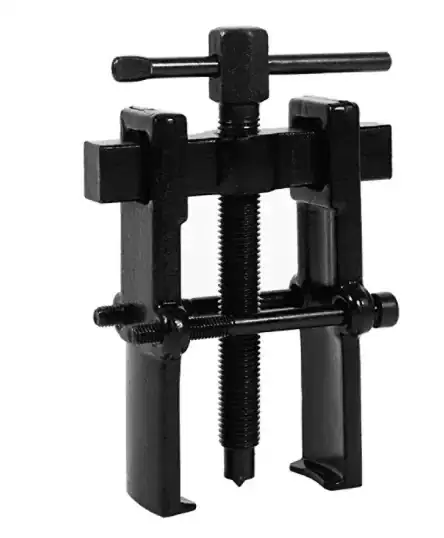

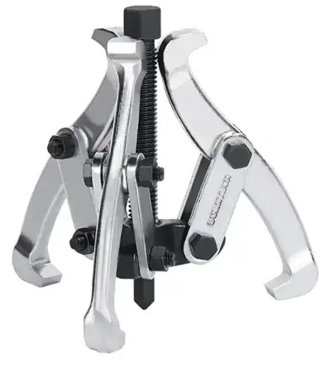

I had exactly the same problem with an Ender 3 Pro I bought a couple of weeks ago (Mar 2021) and I was able to remove the gear easily with a small gear/bearing puller... take a look at Amazon and you will find plenty of selection.
The 3-arm puller works better as it's much more stable when pulling the gear (this is the one I have). Both work in the same way; the arms/jaws attache to the bottom of the gear and the tip of the top screw pushes the motor shaft down.
BCD

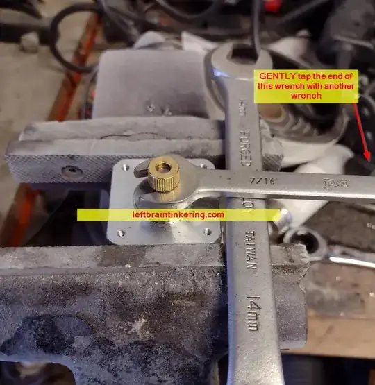

I accomplished this by using a pair of open-end wrenches and some heat.
  1. Heat the brass gear end with a butane torch or a MAP gas torch
  2. Clamp the stepper motor into a vice
  3. Position two open-end wrenches such that you can use the open-end part of one open-end wrench underneath the brass gear while the second wrench is positioned perpendicular to the first one, underneath it (photos in below article will help visualize)
    Using a couple of wrenches to pop the brass gear off of the motor
  4. Gently tap on the end of the first wrench, to release the brass gear
  5. Install the new gear, but you will need to grind a small flat on the shaft of the stepper motor so that the set screw has a landing.
The idea is basically making a lever out of one wrench, and using impact force to release the gear.
See this article for visuals: Micro Swiss Direct Drive Installation for Creality Ender 3 Pro with a Press-Fit Extruder Gear
skelliam
  • 139
    When using a pair of wrenches to remove the gear. If I understand what they're doing, it's likely to damage the bearings of the motor. Always best to support the shaft and never use the bearings as something to press against. – Neil in MA Mar 25 '22 at 15:08
    @NeilinMA The article mentions that a gear puller is the safest approach, as it counters the removal force on the gear with the same counteracting force on the shaft. That being said, I doubt the method depicted here is any more *likely* to damage the bearing than any other method that does *not* involve a puller. – skelliam Mar 26 '22 at 17:33
