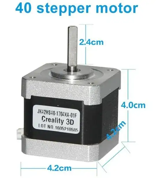

Steppers are sized by the dedicated standards, for a NEMA 17 stepper (most frequently used in 3D printers) the width and depth are 42 mm. This is the 42 from the designated naming found by Creality steppers (42-40, 42-50, 42-60, etc.).

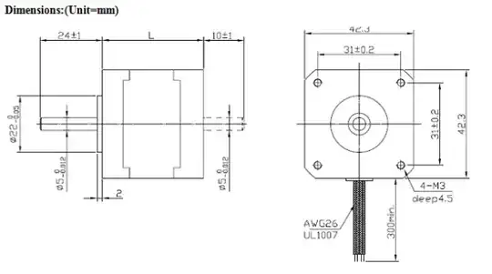

The second set of digits in the naming relates to the stepper body height (in the image below, this is the L dimension), not the overall height! The shaft has its own dimensions, usually these are about 22 mm, but Creality has ordered custom made steppers with shorter shafts with press fitted filament extruder gears (see Problems with stock gear with no screw on Ender 3 pro).

Do note that the naming is short for the model number which is usually much longer, e.g. JK42HS40-1004AC-01F, you see the width/depth and length back in the model name. Note that generally speaking, larger length steppers create more torque, the longer the motor the higher the torque (exceptions apply when different gauge wiring in the stepper is used).
NEMA 17 dimensions
A 42-40 stepper motor

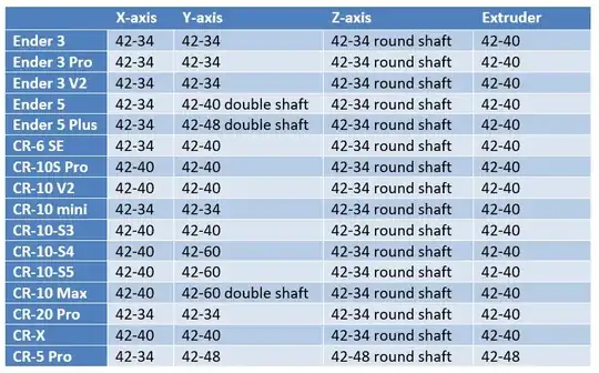

The following image gives an overview of the steppers used by Creality models. As can be seen, they do not always use the typical D-shaft steppers, but also steppers with round shafts, this makes it more difficult to attach pulleys with grub screw without creating a flat spot on the shaft. Note that double shafts means that there is a shaft on both sides of the stepper motor, this is convenient for attaching a knob for manual positioning.
Steppers used by Creality models
